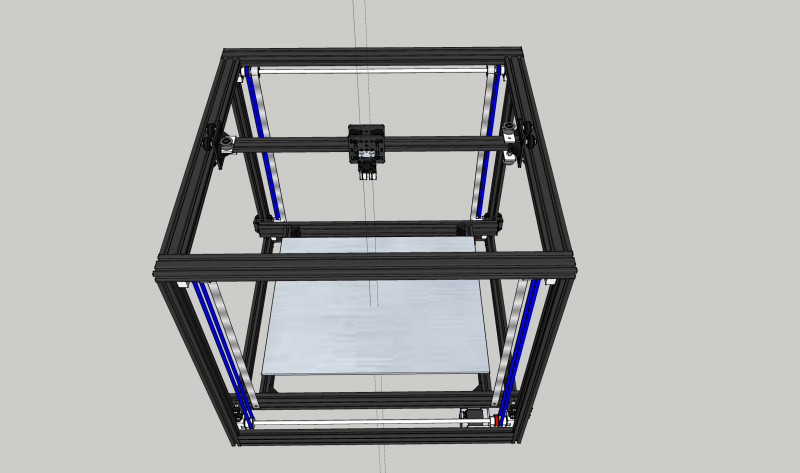

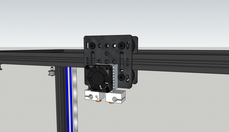

    Yeah, I think a dual Volcano nozzle with a combination of 0.4 and 0.8 nozzles may do nicely.
    Two nozzles gives me access to the entire bed on the Y axis, and about 410+ mm on the X axis for both nozzles.
    Also gives me some space to put cooling fans on the back of the carriage...
    Plus, I can also switch back to a Chimera configuration with the dual v6 nozzles if I want smaller nozzles for detail pieces.

    Lookin' pretty sweet! I think you're almost there. I'm not sure how you are going to run your belts above and below the gantry though. I really like how the springs and belt driven Z axis worked out - it has great symmetry and I like how it opens up visibility to the build area. It almost makes me want to swap out my lead screws but I think I am going to go ahead as planned as it is a less complex build that I think will be as robust. I can always change to belts later - I've already checked all my measurements - I wouldn't need to change anything else and I can get all the parts from robotdigg for about $64 (plus shipping).

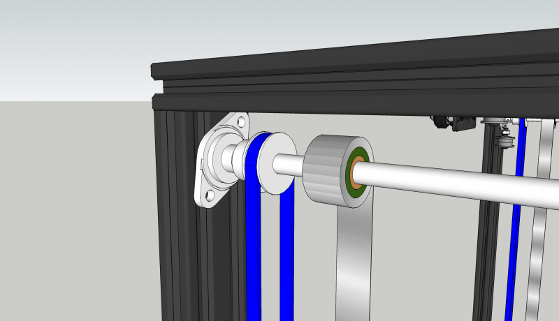

    The X/Y motors will be mounted to the top front rail, one with its pulley above the bar and the other upside down, pulley below the bar.
    Should be plenty of clearance for the belts.

    I saw that. I just wasn't sure where the belts were going to be routed as the Z axis belts and constant force springs seemed to be in the way of where you would need to route belts for the lower gantry belts.

    Yeah, good point.
    I'll make it fit, I only need about 10-15mm of clearance width for the belts to pass through.

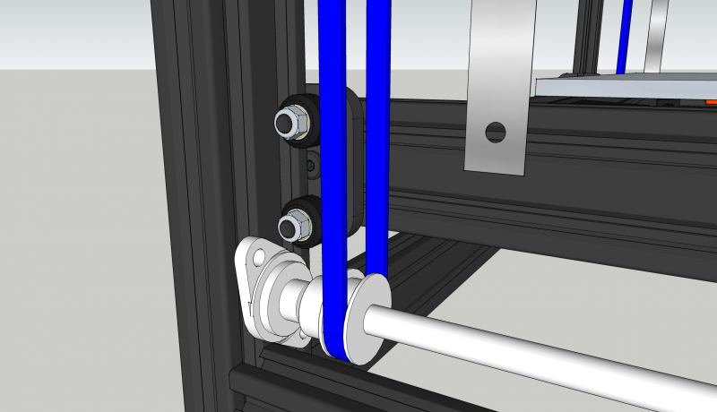

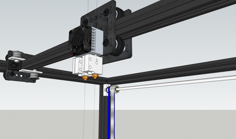

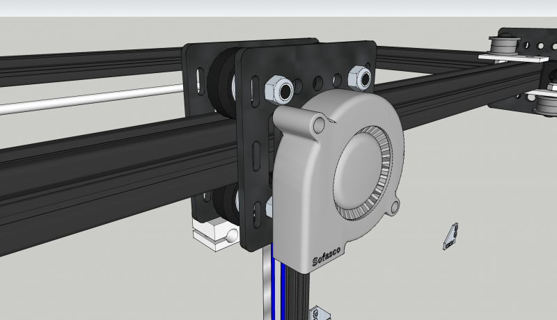

    Rotated the bearing blocks by 33.226 degrees to have the two holes line up for a 20mm distance, and set them to the middle of the 20x40 vertical beams.
    The top and bottom bearings are rotated in this way to give the Z axis wheels more vertical room to travel.
    With an E3D Chimera w/v6 hot ends, it makes for just over 440 mm of vertical room - 430 mm if I use the longer Volcano hot ends (they're 10mm longer).
    Plus, there's enough room on the back of the hotend carriage for a 5015 blower fan.
    I'm also going to squeeze in an inductive proximity sensor for the Z-probe/Endstop.

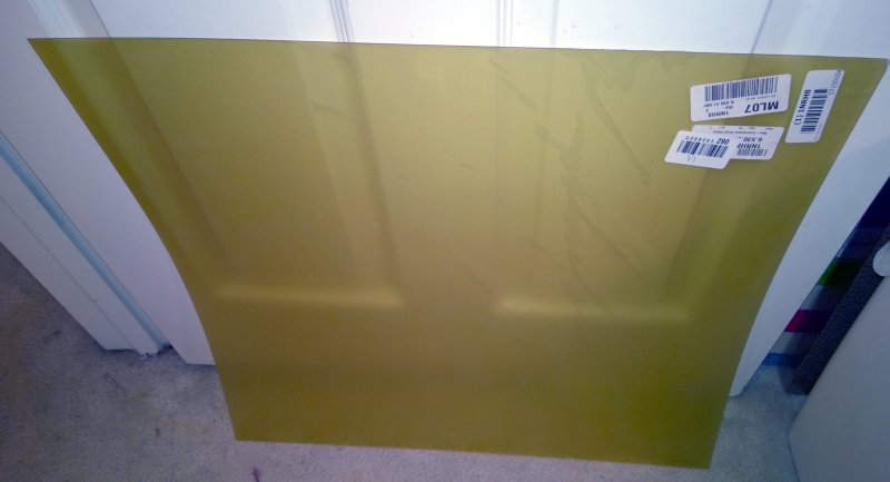

    So the giant sheet of PEI arrived today - 24" x 24", with one side slightly textured, and the other side smooth with a peel-off protector.
    It's only about 1mm thick, but relatively stiff by itself.
    I'll see if the aluminum plate is flat enough (on order), and if so I'll apply it smooth side up with adhesion tape.
    The springs also arrived - pretty strong!

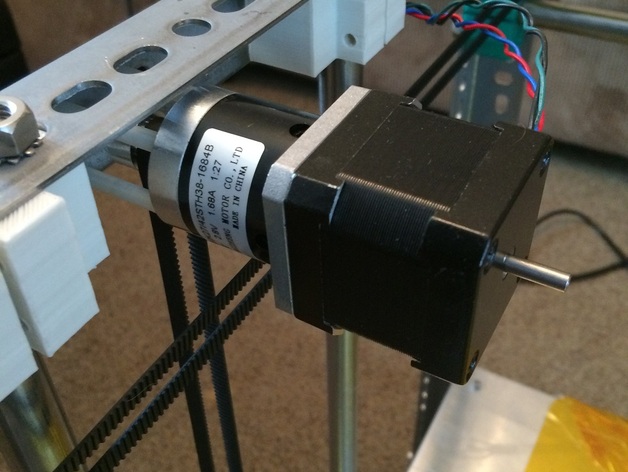

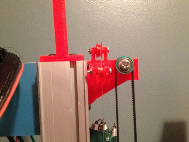

    I've done a couple belt driven z-axis builds and I've found keeping good belt tension is paramount to proper performance. I've also implemented fishing weights as counter weights on my Ord Bot z-axis conversion:
    The heavier the z-axis, the harder it will be to set good tension. The springs are probably a good solution to this.
      File size:
      122.2 KB
      Views:
      350

    How heavy would you say is too heavy? What weight is optimum? Is 'weightless' actually desired? Do you think my current lead screw config would be less problematic (http://www.openbuilds.com/threads/h-bot-corexy-cube-with-fixed-build-plate.1528/#post-15495)? I haven't competed an order for a belt option yet...

    I think your leadscrew configuration may be easier to setup and maintain in my opinion. With that said, I do like the belt design by Giuliano. What's an optimum weight is a great question. I would say the lightest you can get away with if using belts. I'll use a machine I designed for reference I called the "Slot Bot". My bed size was 20" x 20" and it was heavy! I'd say it was pushing 10 lbs with the plywood, LM16UU bearings, 1/8" aluminum plate, etc. I used two geared steppers on opposing sides to lift it. Getting it setup correctly was a pain. Every time I got it right, belt on other side would loosen and I'd start over. In hindsight, the belt I was using probably not rated for it. Here are a couple pics:
    I didn't have a functional tensioning mechanism, so that may have been a large part of my problem.

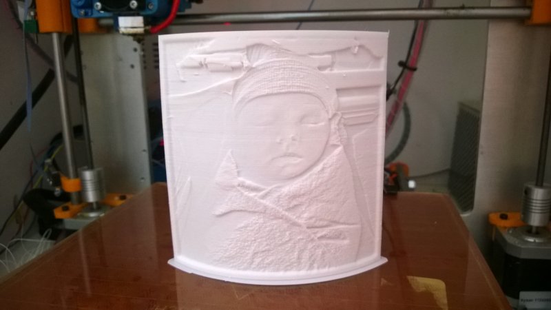

    I gotta say - this PEI sheet is the best build surface I've ever printed on.
    I printed out this tall and thin lithograph with ABS, and a 3mm brim - and it stayed on for the entire 4-hour print.
    Popped off very easily, used a plastic card to get under the brim.
    I set the bed temp to 115, and it was about 100 on the surface of the PEI.
    This printed in an open enclosure, and it came out great!
