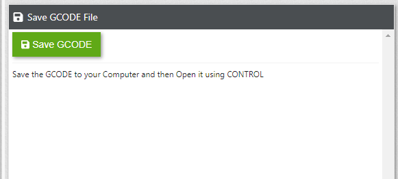

    hello,
    I have been using my lead1515 machine for a while with no issues.
    Today, im trying to work on it and when im on the cam website, after generating my code it does not allow me to transfer it into my control. It only give me me the option to save it. When I save it and open it in control, it brings me back to cam & the page is blank without my design.
    I have updated the control 2 time, uninstalled it, redownloaded it, made sure firewall access is granted and it still does not let me transfer. Attached is a screen shot of what its showing me. I am on windows. Can someone please help or let me know if the systems currently down? Thanks!
    15,600
    4,448
    Make use of the SAVE GCODE button provided (not the Save > Workspace button) - just one extra click :)
    Then go to CONTROL and use File > Open GCODE as instructed
    Updated SSL certificates will be available in a CONTROL update tomorrow which will re-enable Transfer

    Hi thanks for the quick response.
    I explained that even when I save the gcode and open it in the control, it sends me back to the cam website and the canvas is then blank without my design. So something isn’t working.
    can you please explain what SSL certificate is as I’m still new to this. Thanks.
    15,600
    4,448
    That sounds like you are opening an OBC file not a gcode file. OBC files gets sent back to CAM - please double check

    Something you'll receive when you get the automatic update to V1.0.363 of CONTROL. The current certificate expired a couple hours ago, had to issue a new certificate and build an update release (v1.0.363) and set it up to be pushed out to you. You will receive it shortly. In the meantime the Save Gcode option was just tested again as working, so that is always an option when the Transfer option is temporarilly unavailable for whatever reason.
    Make sure to update to V1.0.363 soonest and all will be well again.

    Alright perfect! Not sure why it was saving the other way, it's now saving as gcode.
    Thank you for explaining and for your help!

    Sorry to necro an old thread, but I'm having this same issue today, running v1.0.370 of CONTROL. I haven't used my machine in awhile & was surprised to see this option missing.
    Any insight?
  8. Peter Van Der Walt
    15,600
    4,448
    Feature has been disabled. Use the Save Gcode button provided thanks
