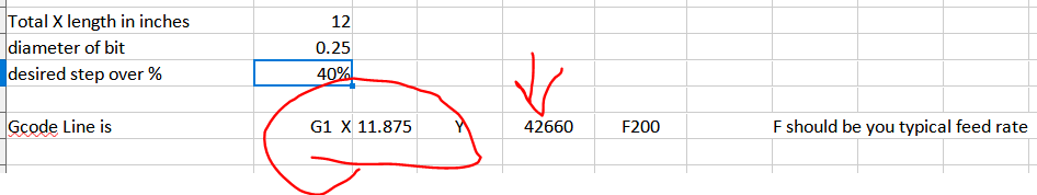

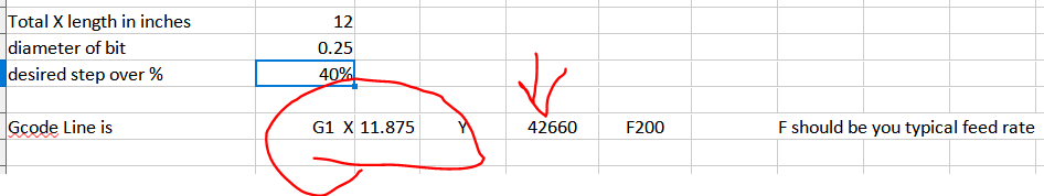

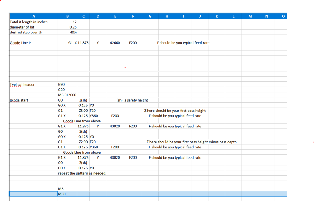

  19. Giarc
    3,062
    1,714
    It is a spiral that moves down the x axis.
    It sends the cutter X= 11.875 inches and Y42660 (I believe degrees = 118/5 revolutions) as a spiral at 200 inches per minute.
    Whole picture of spreadsheet if someone smarter than me wants to chime in:
    #19 Giarc, Mar 29, 2024
  20. Phil Adkins
    Feb 22, 2021
    Yeah, the problem is (as far as I can tell) that it does not seem to move, it just repeats the same numbers?
  21. Giarc
    3,062
    1,714
    I just looked at it again and yeah, I can't figure it out either. That is too bad. It would have been a handy tool. When I have wanted to make round stock in the past, I just created a simple cylinder stl file in Fusion360. So, If I was cutting an object from a 4x4, I would make my cylinder 3.5 inches in diameter. then using this chart, I would say I was starting with a 4.95 inch thick piece:
