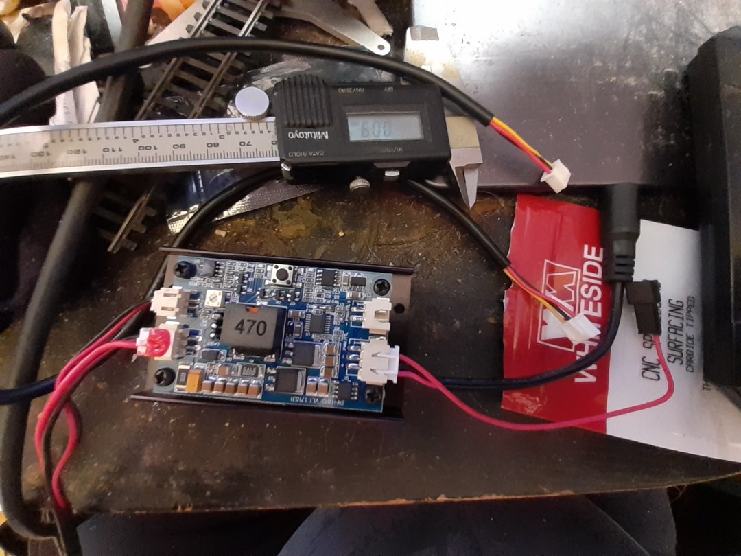

    Hi, I have just aquired a 15W laser unit which I hope to use with my Mini Mill. I am using Openbuilds Black Box controller and Openbuilds control firmware. There is a socket on the Black Box but other than that, I have no idea how to connect the plug to the module as there were no instructions supplied and I am unable to find anything on the internet. I have included pictures showing the connections on the laser control board. Laser 1.jpg Laser 2.jpg

    PWM/TTL pin+GND goes to PWM/GND on the toolhead plug
    Power is supplied to laser independantly of the BlackBox (usually those come with their own 12v PSU)
    OpenBuilds BlackBox 4X Documentation is quite similar just except 3 wires, you have 2x2 pin wires it seems (shared gnd not needed, each has own gnd)

    Many thanks, there is a 2.5mm mini jack connected to the 3 pin jst plug, along with a single wire (red in picture), so I am guessing the 2 pin jst is connected to the Black box. However, there is no ground on the 2 pin jst socket, it is just labelled PWM/TTL + and -. I have no idea what the red wire is for.... 20191002_154830.jpg

    Not sure of the red wire either. Seller may be able to advise
    Pwm+ would be PWM
    Pwm- would be GND
