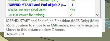

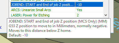

  13. David the swarfer
    3,438
    1,908
    So you changed it in the gcode file at the start (line 22) but not in fusion360 post options, so the ending
    G53 G0 Z-0.3937
    is what dragged through the work.
    The reason for this is that your workpiece is thick enough that 10mm (0.3937") below Z home (top of Z travel) is in contact with the work.
    Thus you have to change the Z offset in the post options to -1 (always in mm, 0.05" is about 1mm)
    upload_2021-11-16_8-13-25.png Note the popup help is visible here too
    The default is -10mm, which is always more than enough to clear the home switch. GRBL sets Z0 home to the spot where the switch is actually triggered so if you go to machine home with
    G53 G0 Z0 it will cause an alarm. Therefore the starting (and ending) safety move always stops below Z0 using
    G53 G0 Z-10 (in mm or equiv in inches)
    In the case of your thick workpeice you will have to set this to a smaller value so that the bit still safely clears the work.
    Fusion should remember this setting for the post once you have set it but for every job you need to think about clearance for a moment before running the job.
    Is it a particularly thick job?
    What are the safe height and clearance height settings? Will they fit given the length of the bit?
    Are they small enough to fit between the workpeice and the top of Z travel?
    Is G53 Z-0.3937 high enough to clear the work?

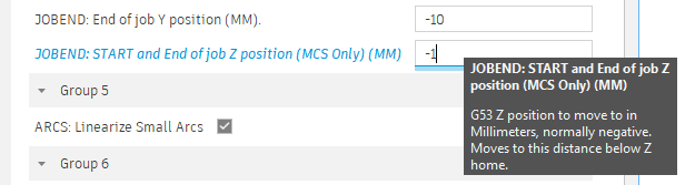

    OR this if you are using the NCprogram interface to the post:
    I suggest running some simple 1 minute jobs on insulation foam, trying different thicknesses and settings until you get this figured out (fail fast, fail cheap).
    Running a 4 hour job on expensive wood is perhaps not the best way to learn (-:

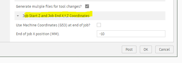

    I recently updated the post to utilize the new property naming and grouping features (submitting updated pull request shortly). I thought it would be cool to have a clickable link to the openbuilds doc section. Unfortunately that's not possible, However, we can do something like this if you want (see first section):

    Yes, I am busy processing your pull request. Problem is the difference between the old post options display and the newer NCprograms style display. The group names work great in the new display but not in the old display (which is selectable as a default).
    Yes, I know Fusion now defaults to creating NC programs and most people will see that, but the old post options must still make sense, even to a new user.
