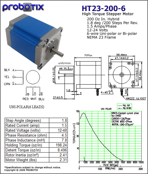

    I took three HT23-200-6 stepper motors off an old CNC router that I built about 10 years ago. Will they work with CNC xPro board?

    I can't find specs for HT23-200-6 motors but I found specs for HT23-180-8 and HT23-260-4 motors at Probotix (PROBOTIX 260 OzIn 4-Wire Stepper Motor). The HT23-260-4 motors draw 2.5A per phase.

  4. jeffmorris
    jeffmorris Journeyman
    Nov 6, 2017
    496
    115
    Rick, Thank you very much for getting me the specs for HT23-200-6 motor.
  5. Mike lopez
    Sep 18, 2017
    I have that same board. I don't think so, since it has its own drivers build into the board
    here is the website description.
    The CNC xPRO is equipped with 4 DRV8825 motor drivers
