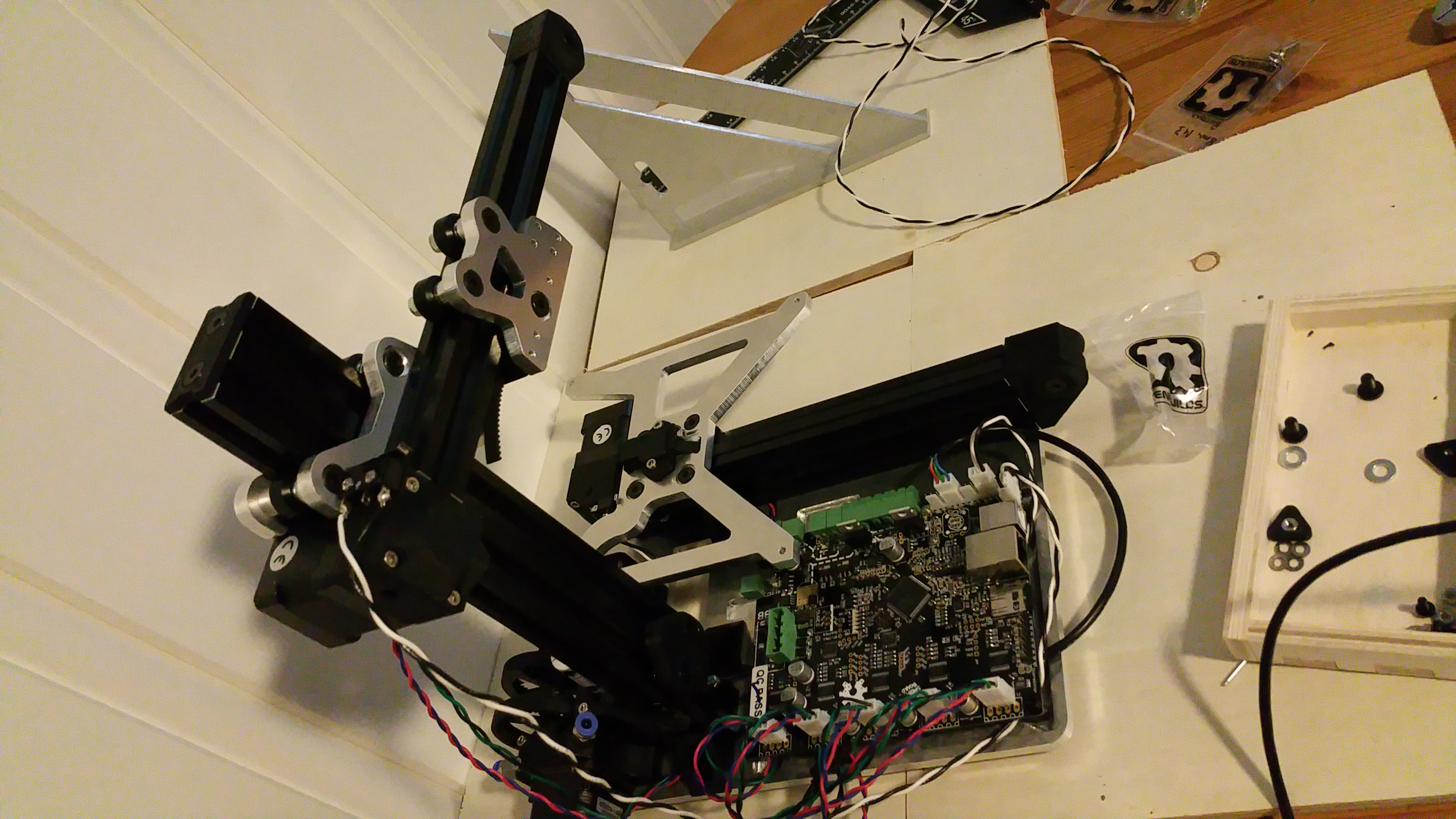

    Stock Indie I2 coming together..
    Kyo and Indieflow like this.

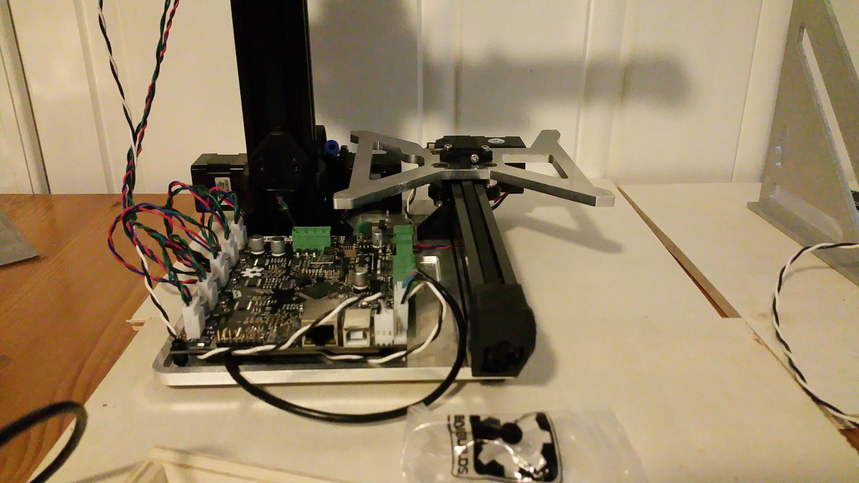

    Received my Cyclops plastic extruder thingy today. Mounted the cold side assembly on the X carriage.
    Also starting to wire the PSU to the Smoothie. I wonder how that goes when plugging it in for the first time. Poof? :nailbite:
    While working on this I started wondering about where to run all the cables that end up on the X rail. There are cables from End Stop, stepper motor, fan, and the hot end on the extruder. Need some ideas there...
    Also - I see the other Indies in this thread appear to have a fan or two blowing on the extruded plastic. Anyone got a tip for me on how to get that going? I have no parts on hand for that.
    Forgive my Noob - my I2 is the first printer I have been within 10 meters of.. ;)
    Edit: Simon, I'd love to see some pictures on how you wired the heated bed to the smoothie.

    I did notice from your pictures that you don't have a voltage regulator fitted! Are you aiming to use two different power sources?
    Wiring is a personal preference thing really! I like to route my hotend, thermistor and fan wires along my bowden tube and my stepper and endstop wires down the Z-axis rail. Also the base has trenches machined in for the Y-axis and extruder wires to sit in nicely :) all really depends on how easily you wish to take the separate axis apart!
    Fans are only required to cool certain plastics! For example if using PLA and you extrude on top of soft hot plastic (previous layer) then it will curl up if not properly supported from below! This can be combated by printing slower or correctly designing parts with overhangs of no more than 45 degrees (my designs use 50 degrees)! Fans can also be a bad thing when printing certain plastic like ABS so I have left this option open to builders by leaving a large section of the X carriage available for mounting fans if needed! I personally don't use them!
    Everyone starts somewhere and if your wondering it then others are also! :thumbsup:

    Voltage Regulator - yeah, I've been scratching my head today on how to supply 5V to the Smoothie. I'd hate to be stuck having to power the board with an usb cable or paying for a separate 5V psu so I need to order that.
    Interesting read on the need for fans. Thanks. I'll get the thing running ,then worry about everything else... :thumbsup:

    Progress has been made :)
    Volt regulator in place, also diodes behind the small mosfets. Apparently not doing so is a warranty breaker for the Smoothie..
    My two diodes were delivered at my door in a cardboard box big enough to hold four 0.5 liter cans of beer! o_O That is a lot of empty air for 2 grams worth of electronic gadgets. :)
    While wiring is still a mess I know the following works:
    - 3 axis steppers
    -1 extruder stepper. The other one I haven't figured out how to move in Pronterface.
    -extruder hotend + fan + thermistor. Already burned my hand on the extruder nozzle! :thumbsup:
    -headbed + thermistor
    -2 mechanical endstops.

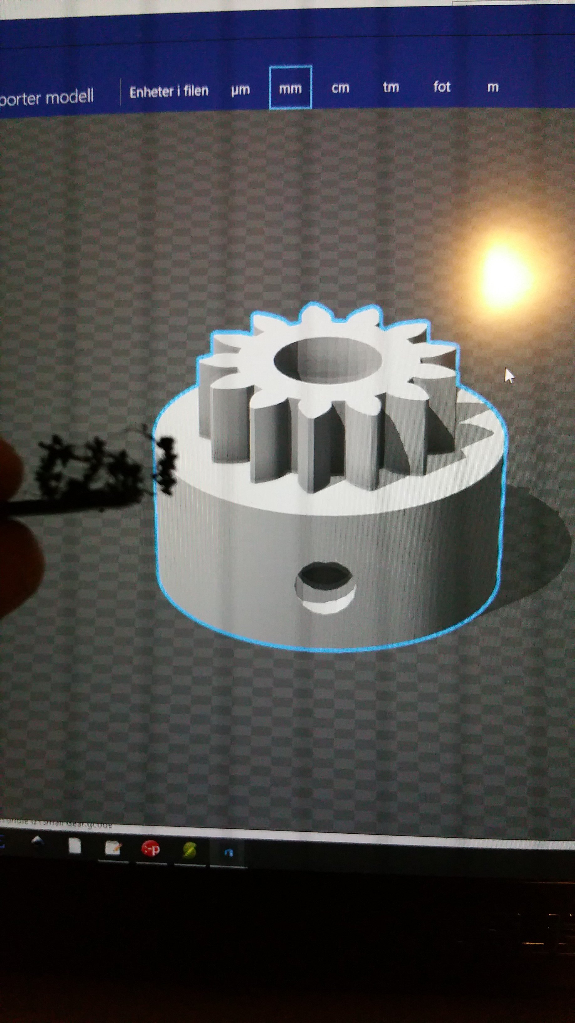

    First print gave me a laugh atleast..
    The small gear I wanted to print and the result in picture below. Looks functional enough... :ROFL:
    Now to try and figure out why the thing stopped pulling filament...

    Did you go straight for printing the small gear before calibrating? :nailbite:
    If not how did your cubes, torture test etc come out?

    No, I did check that the extruder would deliver a sensible lenght of filemant before plugging into the hot side of things and attempting a print. Asked for 100mm, 40mm and 5mm of feed and what was brought forth by the one working extruder was reasonably close to expected.
    The small gear was my test "cube". First two layers look nice though, but that is perhaps just the chamber holding melted plastic emptying out. It appears to me that feed drops or stops somewhere along the line after starting print.
    Next attempt tomorrow evening.
