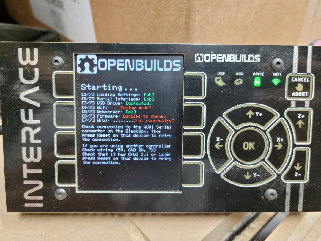

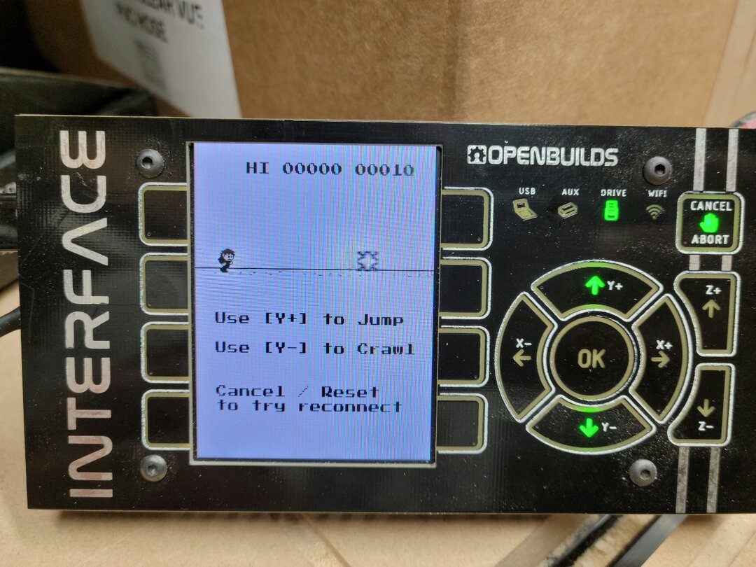

  15. Yohaneg
    Yohaneg New
    Apr 24, 2021
    Hi there.
    I've been running my machine with my laptop for like a week now no issues. I have the Interface but can't get it to work. When the interface starts I get that image and couple seconds after I get the jumping game. I never get pass that screen. I'll appreciate any help.

  17. Peter Van Der Walt
    Builder Resident Builder
    15,699
    4,511
    Did you remember to Unplug the USB cable to make the BlackBox switch back to Aux mode?
