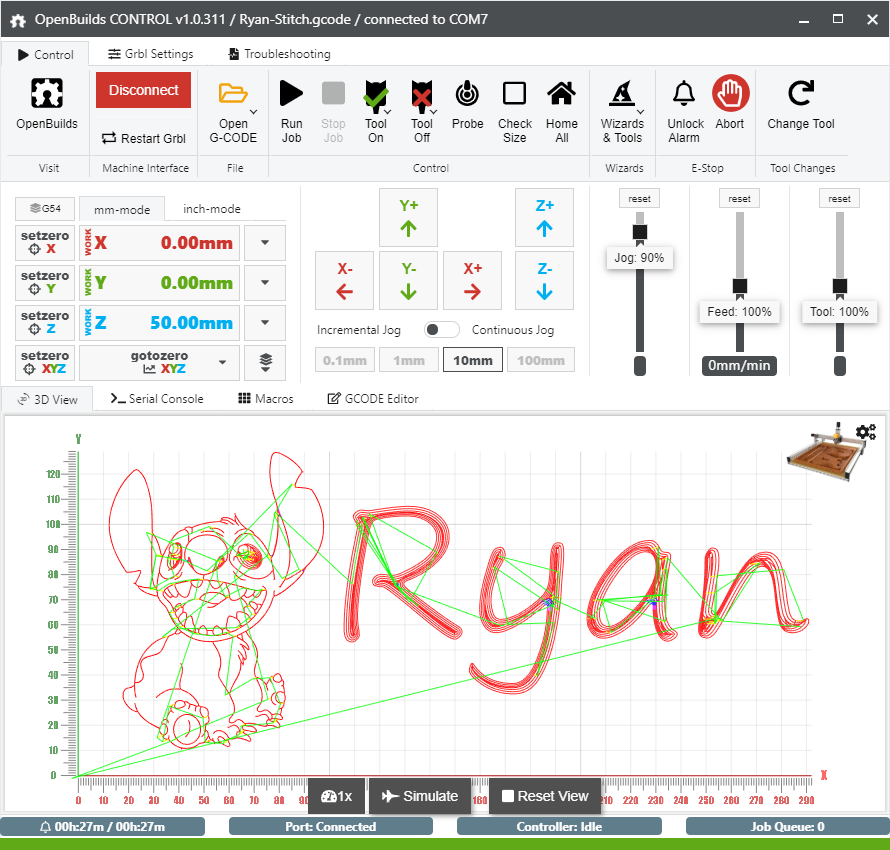

    The code looks fine. From X and Y zero, it should only move 291.519mm in X and 128.878mm in Y.

    As Shawn said, xmin and xmax are within your material
    max 291.519 11.47"
    min 11.868 0.467"
    note that your x0 y0 point is therefore about .5 inch left of the drawing itself, same in Y, but this is not the problem if you see it going 4 inches beyond the edge of the board.
    so, not the gcode, logic tells us it must then be calibration (or maybe EMI, but that does not usually add steps)
    so, calibration. you mentioned a 10mm command moves 10mm. but this is much too short for calibration, rather calibrate against a 12" rule

    Ditch grblpanel, if I recall correctly it was last updated many years ago and has missed some new grbl features.
