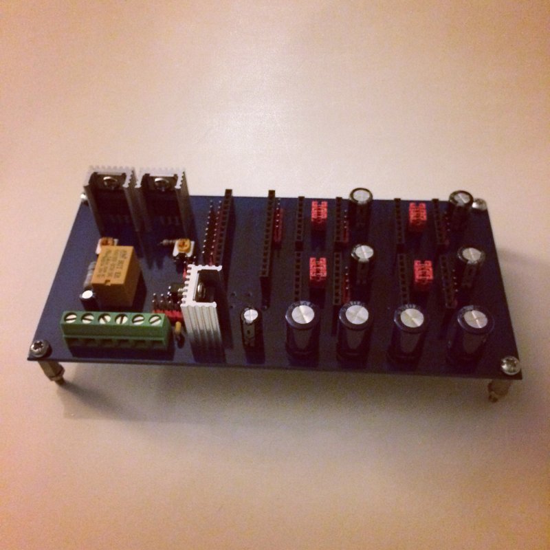

    Here is the test board of the LD3X, just populated it and now going to test things out :)
    JCPhlux likes this.

    Ahh man. now I wish I had waited to get mine. That is lovely.

    If all tests pass then the prototype board is yours & I will confirm my order for the new lot ;)

    So far all testing is good each access operates correct and laser controls also function :)
    I don't have 4 spare motors to test everything with so each access was tested one at a time running the Wol g-code file
