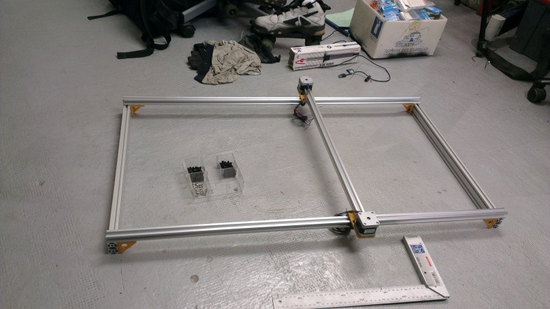

  7. skarab
    skarab Journeyman
    Jan 5, 2014
    96
    144
    I still had some 20x40 aluminum profile and 20x20x1000mm v-slot from my last build. Your project running through my head for a while. Pending the material for the OX, I started a laser router wickedly inspired by your construction.
    Thank you for sharing :D

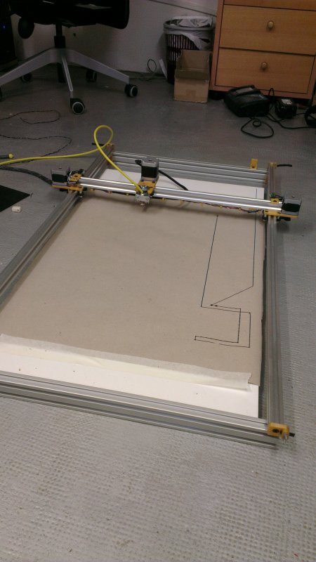

  11. skarab
    skarab Journeyman
    Jan 5, 2014
    96
    144
    Too happy :D A big thank to Robert Hummel for his build log, OpenBuilds and all the DIY community! Next the OX :thumbsup:
    2014-06-22 17.13.52.jpg 2014-06-22 17.12.35.jpg 2014-06-22 17.13.00.jpg 2014-06-22 17.28.40.jpg
    Mark Carew and Robert Hummel like this.

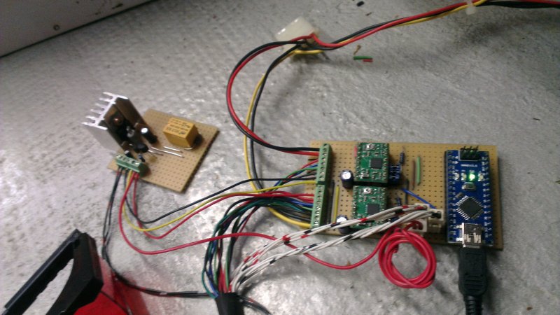

    So after going through end user suggestions, the following updates have bin added to the laser V LD2X
    -Power indication LED
    -Relay is powered by 5v regulator rather then the arduino
    -Relay contact rating of 3 amps
    -Regulated 5v pin rail added along side of the negative pin rail
    -Manual laser on/off pin-out for a momentary switch beside the reset pin-out
    -Dual stepstick Y axis
    -Single stepstick X axis
    -Single stepstick Z axis added for laser focusing
    -RX/TX pin out
    Everything else is the same, board size was enlarged by 20 mm width wise.
    Again I have kept it single sided for easy DIY
    The updated file will be posted soon along with a parts list

  25. Robert Hummel
    Robert Hummel Custom Builder
    Moderator
    Nov 14, 2013
    978
    717
    New LD3X test board :D
    Wiring and getting ready for full testing :thumbsup:

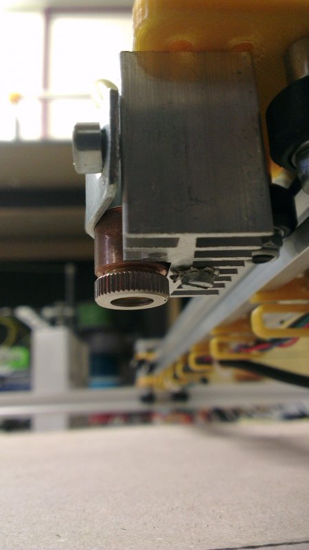

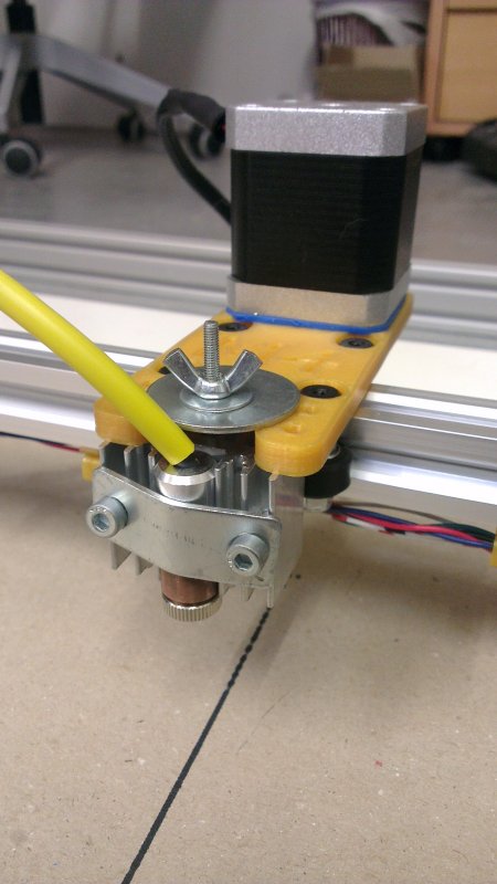

    skarab Journeyman
    Jan 5, 2014
    96
    144
    2W Laser diod from eBay.
  29. Robert Hummel
    Moderator
    Nov 14, 2013
    978
    717
    Part number is M140
