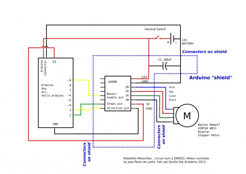

    I'm really late to the party! I am in the breadboard stage for building an X-Y laser cutter/engraver and have have lots of questions. So far my setup is, a clone Arduino Nano, A4988 drivers, and two stepper motors. Does the stepper enable need to be pulled high or low? Does the logic level voltage on the driver boards need to be 3.3v or 5v or does it matter? And for Robert, where can I download your hex file of Grbl? That's all for now, I think.

    Here is how the arduino is wired to the stepsticks then to the stepper motors
    I use pins 2,3,4,5 for step and direction then join sleep and reset on the PCB to enable the driver when powered on.
    Enable is not used
    My hex is in the files section of the build

    I found and downloaded the hex but see from the picture there is a connection from pin 9 on the Uno to the driver board. Is that correct? Also I think I remember reading that you have the laser control on pin 12, Is that correct?

    Yes the diagram is from the net and I don't use the enable pin 9 as jumping the sleep and reset pin will enable the driver at all times when powered on.
    I have compiled the hex to use pin 12 as laser on/off

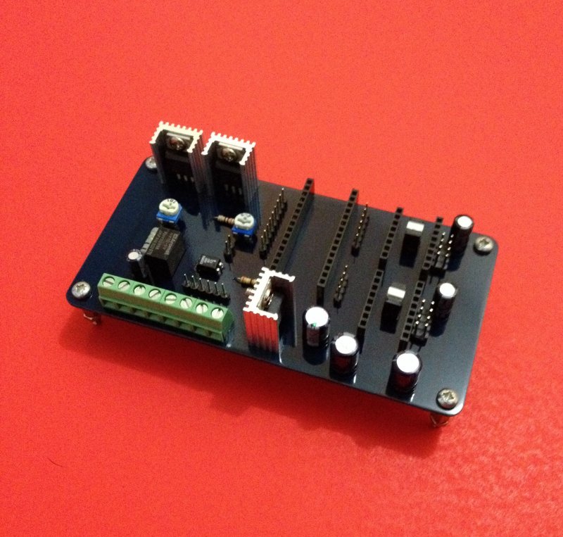

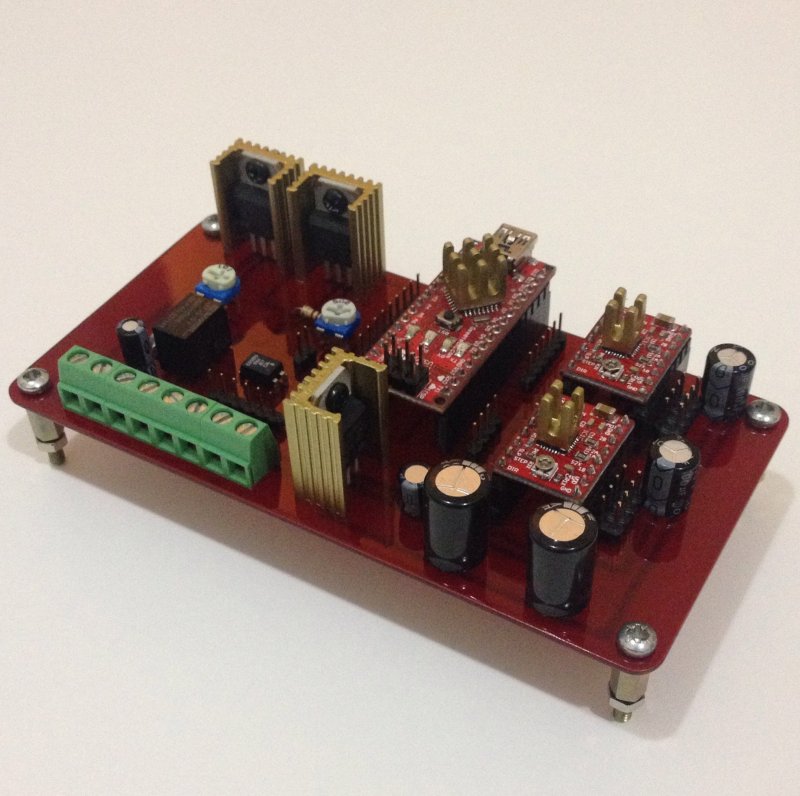

    Robert, I finally received the board. It looks great. Can you provide a diagram that specifies all of the jumpers and orientation of the nano and stepper drivers please? and maybe a pic?
    Also, what driver files are you using for this board? The hex or Grbl listed in your "files" section? ...and are any changes needed for this new board?

    The new board and last of its kind "reasons I don't feel to discuss" works just like the ld2x just now you have two extra driver slots in turn adding dual divers for the y axis and a z axis.
    There are also reset and manual laser operation pins to the bottom left of the arduino socket.
    Two pin on the right are reset, two to the left are laser on.
    Both just need a momentary switch.
    The board is simple and if you follow the traces you can see just how things work.
    GRBL is fully customizable so really you need to learn the workings of it to take full advantage of the Arduino's pins that have bin broken out for you.
    Pot to the left is current, pot on right in voltage.
    If you have the m140 diode then full current will not be an issue ;)
    The the far drivers to the right are for your y axis and get there step and direction from the same pins "no need to use up pins ;)"

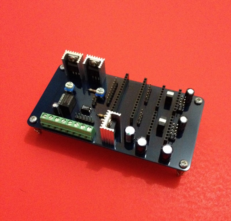

    Could someone post a picture of the bottom of the board for reference, I dont know the entire board layout from the pictures posted yet.

    I was interested in your PCB design, what types of PCB etching boards are those and where can i get them? im sick of the ones i get normally with a drab tan color. these Red/Blue ones look fabulous!
  27. Kyo
    Kyo Veteran
    Feb 27, 2014
    674
    706
    His boards are painted to protect the traces from corrosion. Something like Testors Enamel. Bonus they look awesome. If you just wanted a different color copper clad board to make your pcb from they sale a wide range of colors check out ebay. Or you can dye your pcb with "Rit" dye.
