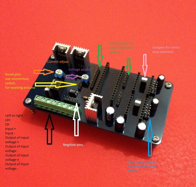

    Here is a pic of my personal updated/ completed board with heat sinks.
    Bit of eye candy

  24. Robert Hummel
    Robert Hummel Custom Builder
    Moderator
    Nov 14, 2013
    978
    718
    Ok kram when your board arrives the terminal strip connections are as follows
    since you have a 1-2w diode on its way then you can crank up your current to max if ya feel the need.
    right now its sitting at .130ma
    Your voltage is set at 8.3vdc so no need to adjust
    Also here is a link that will help explain a little more for you and others about how this LM317 circuit works
    http://laserpointerforums.com/f42/diy-homemade-laser-diode-driver-26339.html
