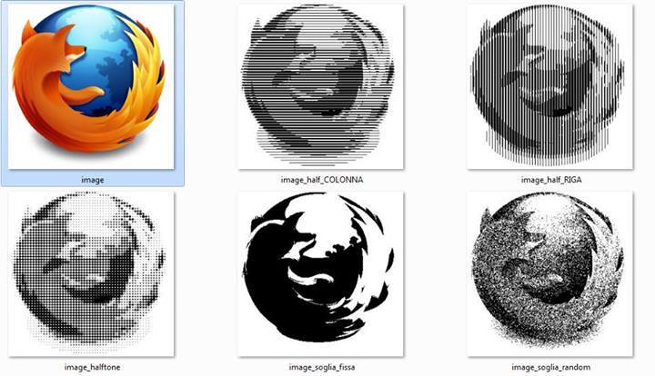

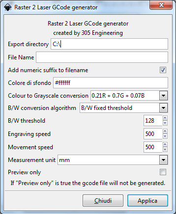

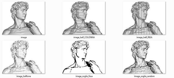

    Right now I'm working on an extension for Inkscape to convert the image in B/W (with different algorithms) and to generate the G Code.
    Some preview:
    Example conversion:
    lexluther and Mark Carew like this.

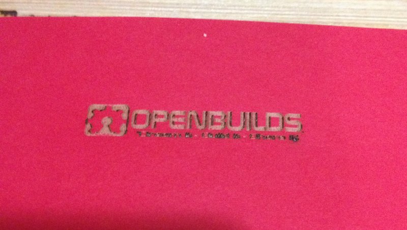

    Well I ran the scaled g-code on laser v and for some reason I have no control over the mm a sec so I had to find something the laser would affect at the speeds it was lasering
    Here are the results

  17. oni305
    oni305 Well-Known
    Jan 16, 2014
    106
    85
    Nice ;)
    I haven't put any setup on the speed in that file, so it will run at the default speed
    GRBL:
    $4=500.000 (default feed, mm/min)
    you can modify this parameter, or send a command like "G00 X 00 Y00 F value" [i don't knov if only "F value" can be sent]
  18. Robert Hummel
    Robert Hummel Custom Builder
    Moderator
    Nov 14, 2013
    978
    718
    I see :)
    I tryed adjusting $4 but had no luck, then adjusted $5 and it worked ;)
