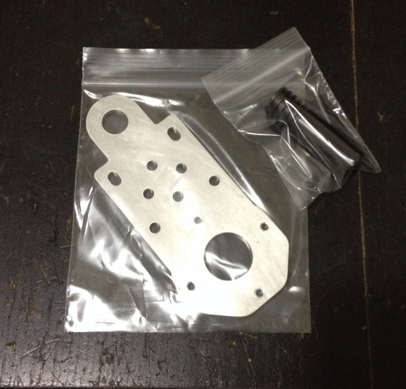

    As soon as I source all the parts that are out of stock or not sold on openbuild I am pulling the trigger so at the latest it will be two days. How do I get on the prototype list for the laser Plate :)
  7. Robert Hummel
    Robert Hummel Custom Builder
    Moderator
    Nov 14, 2013
    978
    716
    Let me see what I can do for the laser plate, are you planing on using a nema17 motor?
    I may even have a spare diode housing here some where

    This would be my suggestion
    http://m.ebay.ca/itm?itemId=170898388161
    I milled something up fast before bed and I did have the extra diode housing to go with it.
    PM me your mailing address ;)

    @Robert Hummel You think you could post a pic of your end stops
  21. Robert Hummel
    Moderator
    Nov 14, 2013
    978
    716
    I was using limit switches but decided to switch to optical.
    Just have not gotten around to building them.
  22. JCPhlux
    JCPhlux Well-Known
    Apr 19, 2014
    209
    48
    So you have not had any mishaps not using one?
  23. JCPhlux
    JCPhlux Well-Known
    Apr 19, 2014
    209
    48
    LOL, copy and paste mishaps :p
  24. Robert Hummel
    Moderator
    Nov 14, 2013
    978
    716
    None as of yet because I set the scale of my drawings to within the travel zone, also use a software limit in grbl
