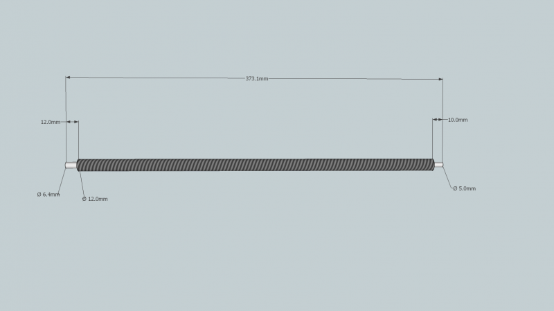

  27. Florian
    Florian New
    Oct 19, 2014
    Hi,
    this should be the drawing of the original lead screw for x & y.
    Hope this helps determining the length.
    Best regards,
    Florian
  28. DiggerJ
    DiggerJ Journeyman
    Sep 2, 2014
    412
    109
    Where did you find that image? I would think the Y axis should be longer, but if that works for both, that solves some time issues. The Y space starts with 480mm, and is reduced by the thickness of the plastic bearing socket on one end, and the length of the NEMA 17 body and shaft on the other. Didn't seem right that those 2 deductions could equal 106.9mm. But I quess id doesn't have to be full length.
    So the flex coupler used would be 1/4" to 5mm, right? If so, I have what I need to know if everyone wants the Anti-backlash nuts over the standard acetal nuts.
    Thanks for the drawing. I am guessing that there is info somewhere I haven't found. I read the build on OB again last night, and scannned for an image on the build manual.
    Is everyone good with the measurements Florian gave?

  30. Robert Hummel
    Robert Hummel Custom Builder
    Moderator
    Nov 14, 2013
    978
    717
    I'm happy with that but would rather both machined ends to be 5mm so I may use OB bearings in the supported ends.
    With both ends supported higher speeds can be achieved with less whip in the leadscrew
