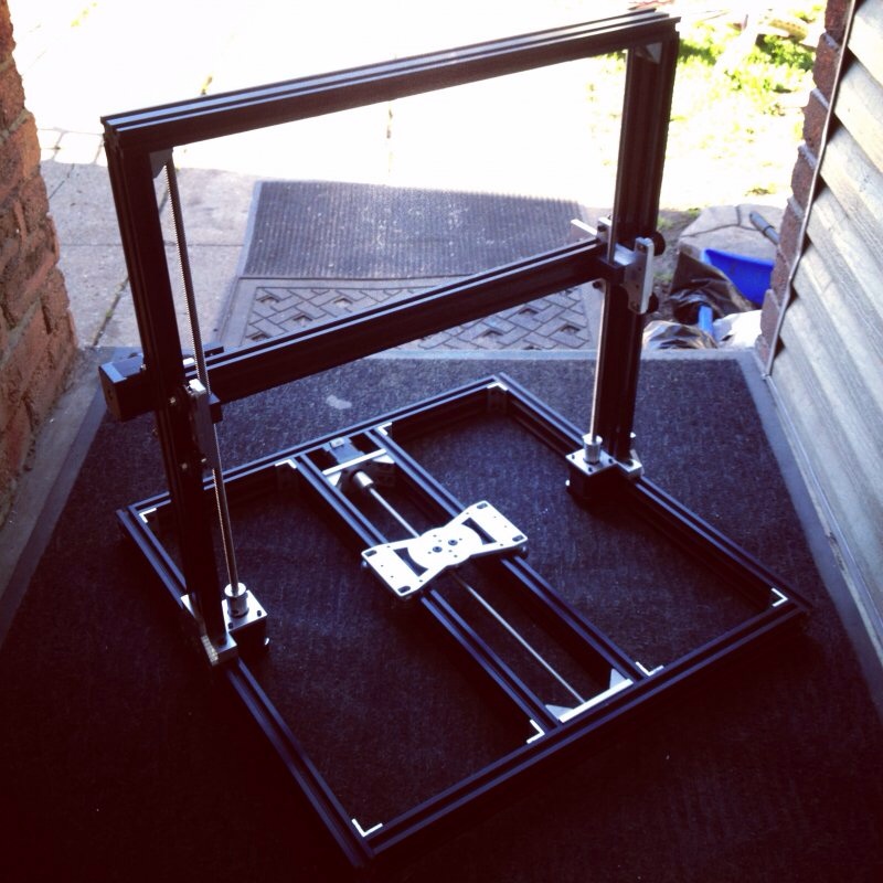

    Finally got around to putting the frame together with the TR8x8 (Z axis) and TR8x20 (X/Y axis) from RobotDigg. As @DiggerJ mentioned, the parts look quite nice. I also had to modify a couple of the printed parts to fit the new screws above. I bought the anti-backlash for the TR8x8 as well. For anyone using this combo here are the new parts. I made the section for the Z axis nut thicker, as I had one snap on me when I was assembling it.
    This is my first time making changes in SketchUp, but hopefully it will help someone else that is using the same combo.

    Thanks for the design of this printer! :) Thought I would give an update of where my build is, all framed and wired. Just did my first print on it and it looks pretty good so far!
