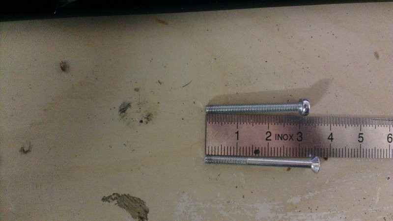

    skarab can you fix the extuder_flange_-_dirty_upgrade.stl Screw hole please
  9. skarab
    skarab Journeyman
    Jan 5, 2014
    96
    144
    what is the problem with this hole? you need to take a M3x40 and cut a good length. It is necessary that the screw, once clamped to the max, does not block the movement of the lever. If I reduce the thickness, I fear it is too brittle.
  10. carl
    carl New
    Jan 16, 2014
    57
    17
    I see now.. i was trying to do a video and was using m3x30's.. so if you countersunk screw hole like the other two m3 x 30 will hold it to tight then ?
  11. skarab
    skarab Journeyman
    Jan 5, 2014
    96
    144
    Sorry I said some stupid things! I drew this piece for M3x30mm countersunk.

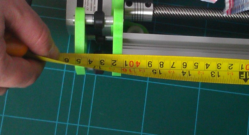

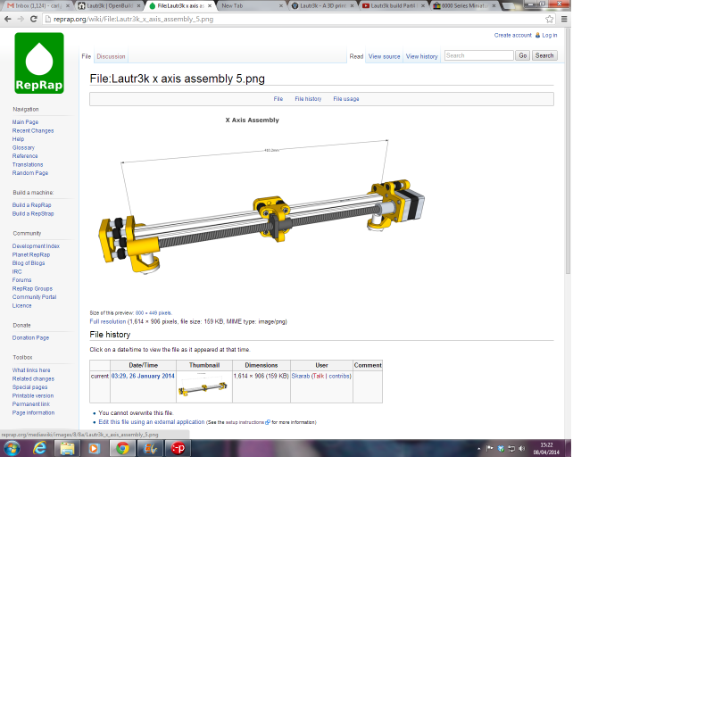

    lu printer.png hi skarab is this 410.2 or 412mm i'm trying to work out how you measure the .2? IMAG0112.jpg
  15. skarab
    skarab Journeyman
    Jan 5, 2014
    96
    144
    Yesss, sorry, I got the E3D. I'm really busy right now (I'm trying to set up my small business). I started designing a new extruder, but I'm not happy ... I'll do my best, but I guarantee nothing. Otherwise I'll adapt a wade greg's like: http://www.thingiverse.com/thing:291980 or http://www.thingiverse.com/thing:291291.
    Yes, it is 410.2mm to be very accurate (I am Swiss ^ ^) but do not worry about it, as long as the distance between the Z-axis are the same on top and bottom.
