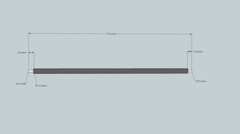

    How do I know what length lead screw to look for? We are not going to find another 10 start I suspect, so will need to look for a lead screw with the most starts possible. Anyone have any other thoughts?

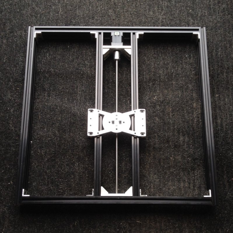

  13. Robert Hummel
    Robert Hummel Custom Builder
    Moderator
    Nov 14, 2013
    978
    718
    Here are the first parts, I'm still waiting on my metal supply to stock back up"sad 3 weeks now"
    Good thing I got a bunch of scraps :)
    This is the motor mount and bearing for the Y access ;)
    carl and skarab like this.
  14. Robert Hummel
    Moderator
    Nov 14, 2013
    978
    718
    All assembled, looks good so far :)

  19. Robert Hummel
    Moderator
    Nov 14, 2013
    978
    718
    I designed it in sketchup along with a 1/4 and 3/8 inch spacer block to fill the void in between the bed and lead nut :)
    Here is a pic of how I connected everything, speed tests to come after work.

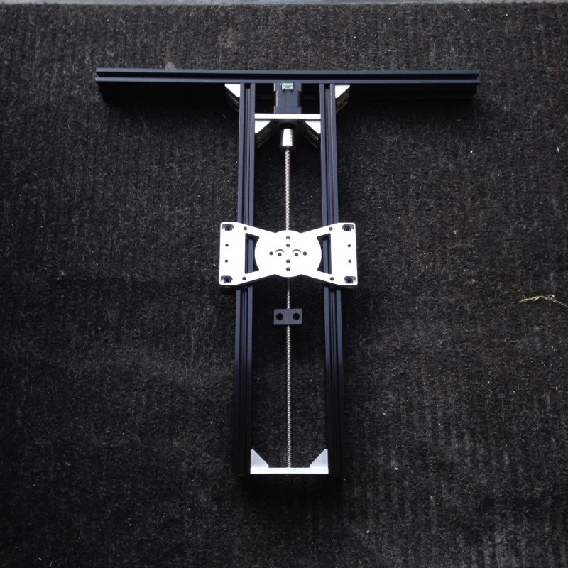

  26. Robert Hummel
    Moderator
    Nov 14, 2013
    978
    718
    I have decided to go with a 2 part mount using 1/4" plate.
    The first is the motor mount with a 30% pocket operation done on it.
    The secound will be a simple 1/4" spacer plate :)

  28. Robert Hummel
    Moderator
    Nov 14, 2013
    978
    718
    Got to test fit the mounts and :thumbsup:
    I didn't plan on making up parts but if it turns out as I hope I may just do that and put some kits together ;)
    I just really need a printer to put all the final touches on my builds so they can all be complete :)
    I will be releasing the files when the build is complete for and milling peps that are looking to build a printer :D
    I should prob do a build log instead of filling this one lol

  30. Robert Hummel
    Moderator
    Nov 14, 2013
    978
    718
    And here it is at a stand still, all out of T nuts and hardware is running low.
    The side mounts for the Z Axis
    All assembled :)
