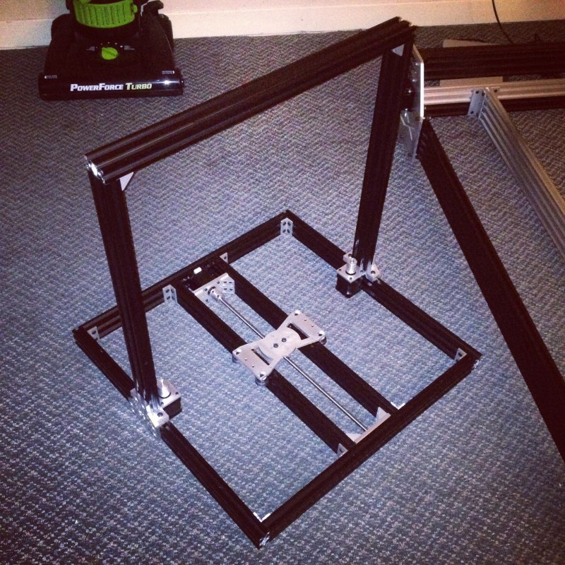

    I went with 480mm 20x40 for the Z rails and also plan to use 20x40 for the X.
    The support rails will be the only 20x20 used so it's sturdy that's for sure lol

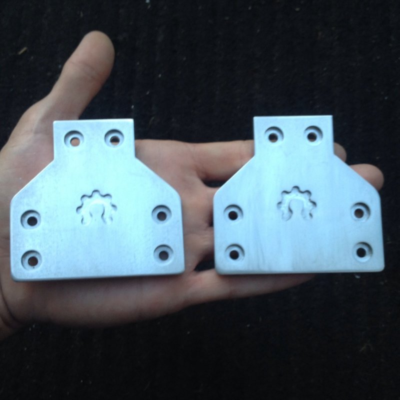

    Little update using pics :)
    Time to cut some leadscrews and design the X Axis carriage :)
    Edit
    Leadscrews installed :)

    Just finished up the last parts, I have the X carriage designed in my nerd just gotta make it up in sketchup and mill it :)
    Support plates, and leadscrew end supports ;)

    Ramps kit came in :)
    The hot end not shipped :(
    The MK2B board is not flat so I'm taking it I have some work ahead of me here lol
    Is it possible for me to just mill an aluminum 1/4" bed with a way to mount the MK2B when need ?
    What solutions are used to get the board flat? as I'm sure that I am not the only one with a un-even bed

    I'm using a aluminum sheet 2mm thick on top of my 300mmx300mm heat bed with auto bed leveling so i don't worry about a un-even bed.

    Thank you so much Robert Hummel the parts you made are here :thumbsup::):cool: iv only just got to want until my wheels turn up now, as the openbuilds uk were out of stock so i've ordered them from USA
