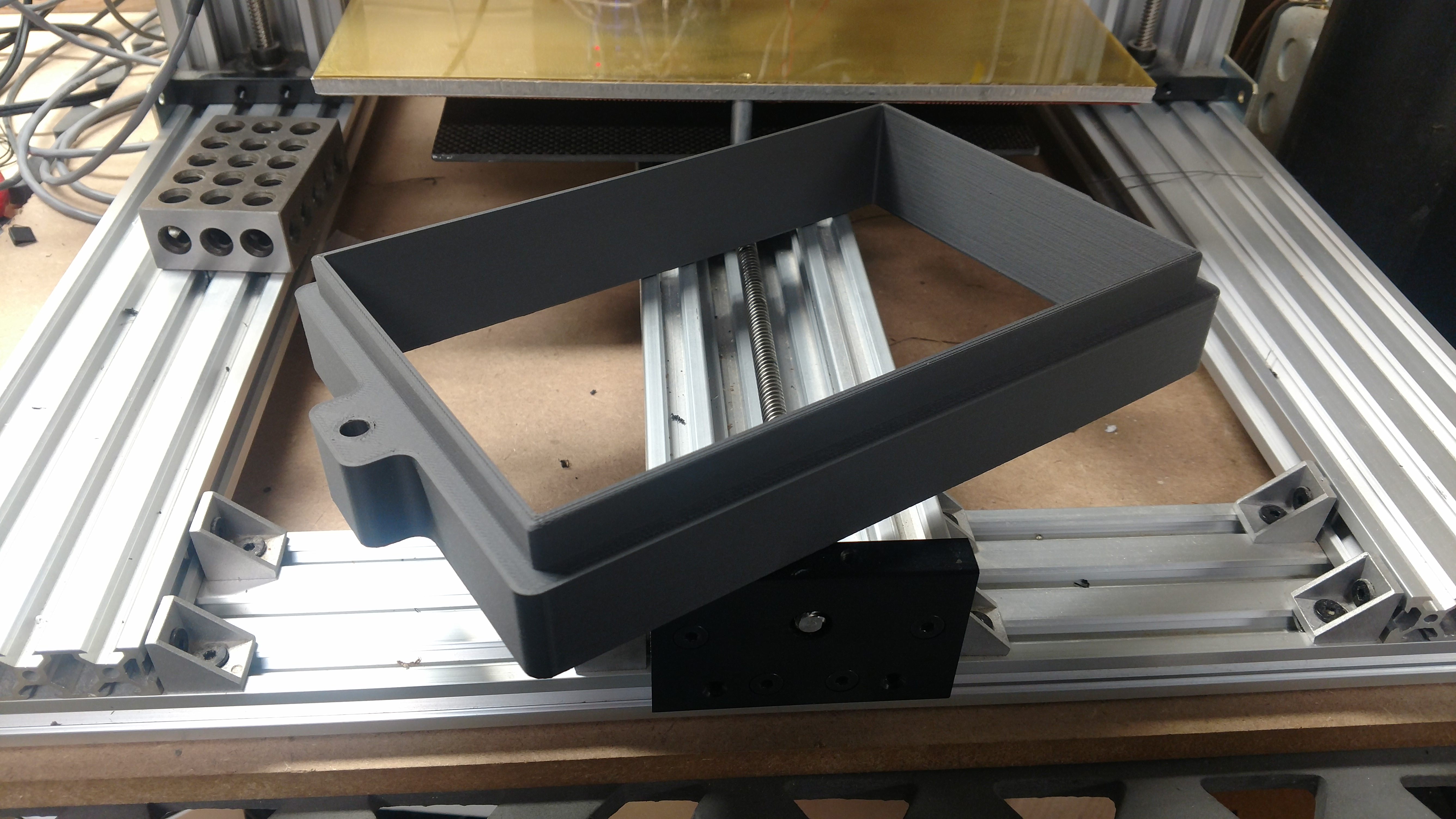

    So, Imgur will have to do for now. Anyway, progress!
    Here is the top plate. Ended up having to split it into 4 due to the poor flatness of my print bed (that is in the process of being remedied). Lap joints everywhere for strength of course. I may re-print this later once I get a flatter print bed (there are a few minor tweaks I want to make, but weren't needed to get started)
    The LCD is resting in there for the moment. The bottom of the screen has the ribbon cables, and as a result is a tiny bit thicker than the rest. I need to shave the support under that side (closest to the Z-axis) so that it sits flat front to back. The idea I have in my head is to leave the LCD proud of the top plate by a few tenths of a millimeter so that the FEP film on the vat is tensioned even more and guarantees that it's as close to the LCD as possible once the vat is tightened down.
    Top side of the vat
    Bottom side. The reduced thickness part is where the FEP film will be taped to. All corners are rounded to reduce the chance of tearing. This also slots in the guide on the top plate.
    This carbon fiber filament prints so nicely!
    Vat in place! The inside is larger than the LCD. This is so I can tension the FEP film, as mentioned earlier, and so that I can guarantee that the print area is as large as possible.
    Currently working on the build platform mount. Should have the design finished on that in a few days, and printed this weekend.
