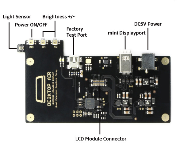

    First. Found a controller board for the 9.7" retina display, only $49 and is made by TinySine.
    Link: Retina Display Controller Board - DE2KTOP Air
    You need a HDMI -> mini DP if you are using the Raspberry Pi. Which brings me to one of the issues of Raspberry Pi, its native resolution is only 1920 x 1080p. Some have managed to re-code the Pi to produce 4K video at 15Hz. But there are better solutions than the Pi - I'll get to that shortly.

    I don't think that TinySine board is going to work for the Gen3/4 LCD that I'm using. The connector is all wrong. That may be for Gen 5 or iPad Mini LCDs though. I haven't looked too deep into those versions.
