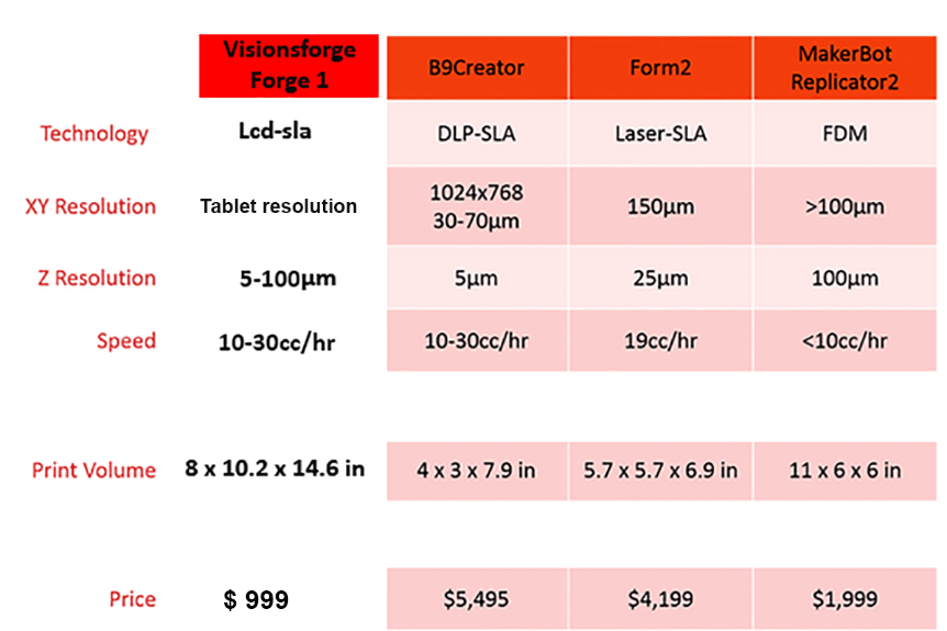

    You have the same question as I do. What is the XY resolution of the Forge 1. Time will tell... if it is actually launched that is. Plenty of projects have never been released.
  17. Oneminde
    Oneminde New
    Jan 24, 2016
    59
    I know which display Forge 1 is using, its the Ipad Pro 12.9". XY print envelope info on home page: 8" x 10.2". The Ipad Pro 12.9" have a resolution of 2732 x 2048 pixels, Display size: 7.74" x 10.32" and 96 microns. Its the only tablet display that makes sense. There is also a 13.3" 1440p display, but the size is off, so can't be that one.
    Which mean yours and mine (since we are the only two working towards 4K) will have a marginally better XY resolution and larger build volume, and that alone is certainly worth a few hundred bux more. $1500 is definitely not a shabby price for this version.

    You know, I had a feeling that it was the iPad Pro. Man, what an expensive way to get the job done (comparatively). I wonder where they are getting the LCD from though. I know ebay isn't exactly a reliable source of parts for production, but you only seem to be able to get the LCD with the digitizer bonded to the screen (not good for print definition). I have yet to find the manufacturer or the part number for that display, but there is a pretty good chance it's an LG.
    Similar size and resolution displays would also be the Pixel C and the Surface 4, but those are physically smaller than the iPad Pro with similar resolutions.
    Panelook.com doesn't have any listing for a display with that resolution. What they do have is a listing for a 65" 8K Innolux display (186 micron XY, 56.23"x31.63") :)

    I'd rather take this SLA than the Forge 1, BUT the Forge 1 is without any doubts a good solution compared to lets say Envisiontec. I wonder if this one can beat the Forge 1 in price.
