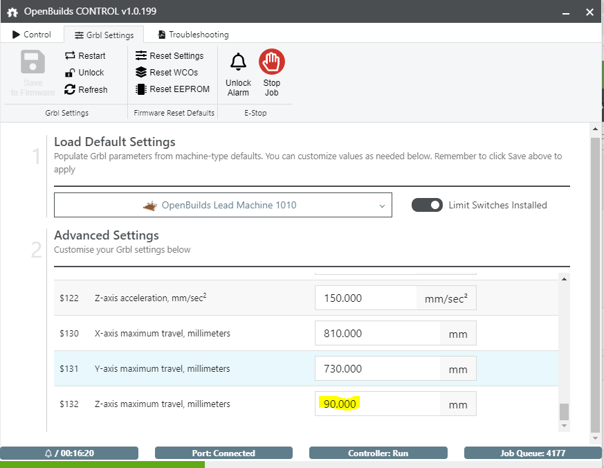

    What would the ideal grbl settings look like for a lead 1010 with the high z mod in the openbuilds software? Thanks!
  2. Mark Carew
    2,764
    2,452
    They would be the same as the LEAD with the exception of adding more height to the Z axis
    So you could update the grbl settings for the Z max travel ($132) to have 365mm in OpenBuilds CONTROL software other then this all every thing else should be the same.
    Hope this helps
  3. stuart wallace
    Jul 28, 2019
    57
    Many thanks. I did that and followed the instructions here too. That led me to change this to option 7 as seen in the screenshot.
    I did the x, y, and z calibration wizards and everything was looking good. I went back to the hello world video and was about to run the job, when I noticed that your values for x, y, and z were positive and mine were negative (see screenshot). This is at about 8:12 in the video. Do I have something backwards?
    thanks a ton
    cheers
    stuart
