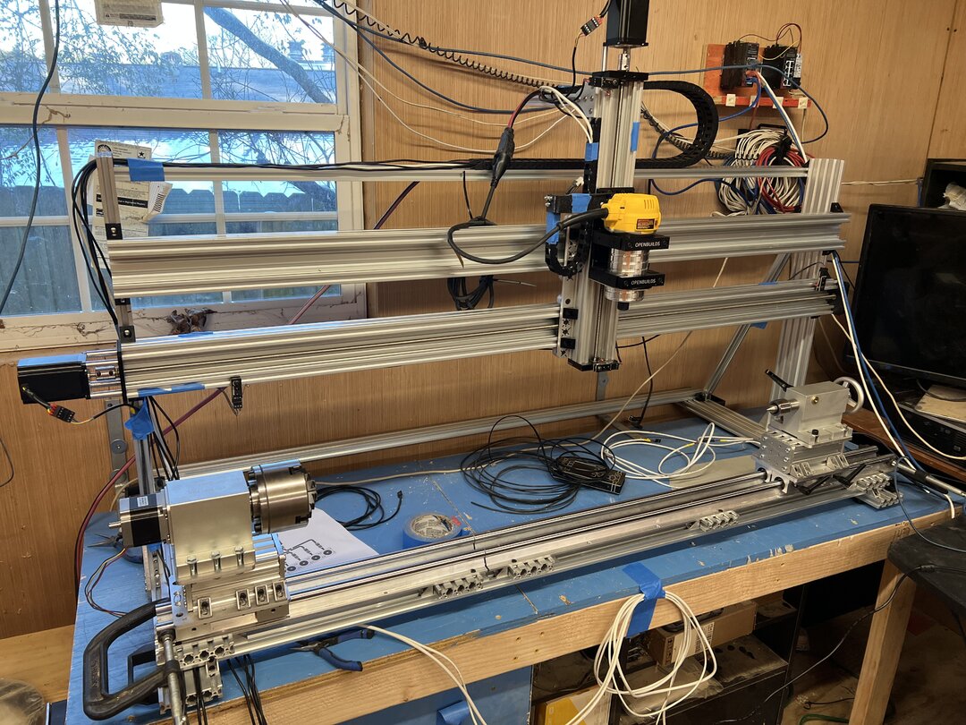

  2. Giarc
    3,062
    1,718
    A guy posted a lathe here awhile back and had written a post processor for vectric v carve. He has removed it since then, but I downloaded the post processor back then.
    I followed a vectric tutorial for using stl files and wrapping. It is actually really quick and easy to do. The software was well worth the money.

    I needed a place to store the old (circa 2011) Windows 7 laptop. All unnecessary software was removed. It only functions as the CNC controller. I was never able to get OpenBuilds Control to function on it so I reinstalled Estlcam. I drew up a quick computer tray that would mount onto and old TV swing arm mount. I have had this mount laying around for about 10+ years. It finally found a purpose.
    This mount was fastened to the side of the Enclosure wall with a large reinforcement "plate" made of HDPE on the inside of the enclosure wall. The tray was made form a "just barely large enough" plywood scrap. It was 3/4" thick so I did some cutouts to reduce weight and to add ventilation for the laptop.
    The hole for the locknut was cut so the nut would be a press fit...with a hammer.
    Perfect fit when stowed
    Painted black to match the cabinet and extrusions.
    And, since I am using Estlcam again, I added the Xbox controller for jogging. I printed a mount in my favorite filament color, Fire Engine Red. I also printed all the channel covers and wire clips in this filament.

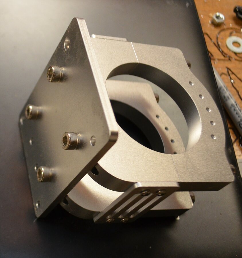

  9. Andrew Barley
    Feb 23, 2022
    I have the same router mount as you with those lovely 6mm socket head screws out the back. Any possibility you could sell me another mount exactly like the one you have. I’m getting my house ready to sell so about half of my garage is packed up and hiding in storage. It would be attaching to that double long C beam width gantry plate with wheels on inside. It’s has 4 risers and another same gantry plate to use that open builds cover to prevent aluminum shards getting in the moving mechanics I am hoping to avoid. Anyway let me know if it’s not a problem or if anyway you can help. By the way your build is beautiful and ensured me I’m not crazy plus so many other good ideas I might be borrowing from you. Keep up the amazing work good sir!
  10. Giarc
    3,062
    1,718
    I am out of town for work right now, but I will message you when i get a chance to look at the file for the plate.

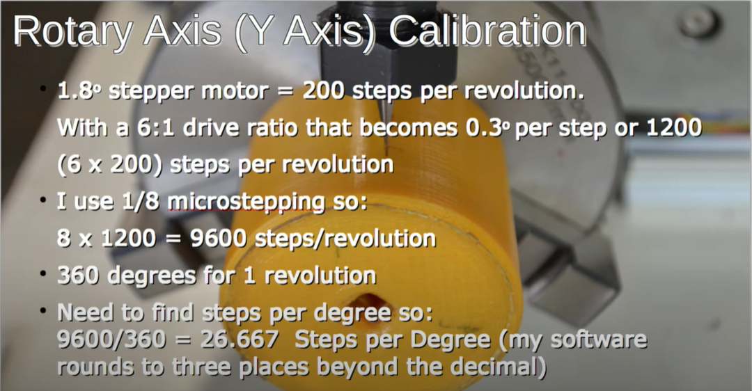

  27. Giarc
    3,062
    1,718
    I show how I calibrate the Y in this video. I was surprised how accurate the rotary was. I did not have to make any changes rom the original "math". Try my Y steps/mm first, and if it is off a bit, then do what I did with a cylindrical object.
    The Y was 26.667 steps/mm rounded to 3 places. So, $101=26.667 in the grbl settings, or 26.6666666667 if you want to type that in.

    This is a complete noob question, but where do I type this stuff in? Do I modify the post processor? Do I need to connect to CNC via computer and not the interface? I feel silly, this is probably a super easy question
  30. NikCNC
    NikCNC New
    Jan 24, 2022
    So I am an idiot, just plugged my computer into interface, backed up original settings and tweaked the y per your suggestion and everything is working great. So sorry, I have only used interface and forgot all about the computer interface to modify the grbl settings
