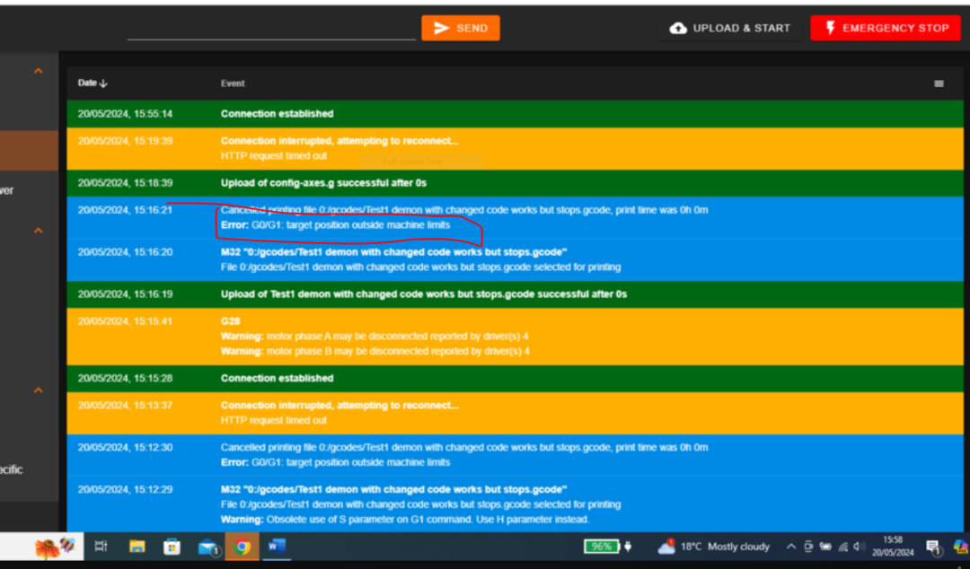

    Hi Alex, thank you so much for your reply we do have the X, Y and A axis working now with much fiddling the A (U) is now working plugged into Y and some changing in config. We did a very quick design in Aspire and put it through the demon processor and it starts off wonderfully doing everything it should but after two minutes the machine just stops, could you just have a look at the gcode and see if there is a problem anywhere, I did add the line (ROTARY_WRAP_Y="U") and like i said it seems to start ok then stops after a short while. Many thanks

    I can see nothing in the g-code that would upset the Duet. Are you getting any error messages when it stops? If so mscreenshot them (show the whole screen please) and post the pics here along with a screenshot of the console log.

    Hi Alex, thank you for your help, I have switched machine on today, it is homing and X, Y and A (U) axis moving fine, I have uploaded and run the Demon gcode test that moves the X and A(U) axis runs fine. When I put the file that I sent you, the same one that worked on Friday until it stopped 2 mins in, no longer works we get the initial movement of Z and that’s it, now bashing head on brick wall lol, I’m sending you the error codes from today to see if you can fathom something, tell me if you need anything else but you can see test in green worked but other file just not working. I’ve not touched the machine since it worked

  7. Alex Chambers
    2,834
    1,393
    1) See advice from @Peter Van Der Walt above.
    2) Use shorter file names
    3) Post the g-code that does work
    4) Is the Duet giving any other error messages when it stops.
    5) I'm puzzled by the message about the incorrect use of the S parameter as there isn't one in the g-code you posted
    6) Am I right to assume that you are using the RepRap V3.3 based firmware from Ooznest?
    EDIT thanks for the better pics.
    Where are you setting Z zero? You are getting some "out of limits" errors which is usually not enough headroom for your Z safety moves on a workbee.
    I don't understand why you are getting errors about spindle speed when you don't have spindle commands in your g-code.
    I really need to see the g-code that works for comparison.

  9. Peter Van Der Walt
    Builder Resident Builder
    15,699
    4,511
    Caught my eye too:
    Soft Limits error, if it was Grbl i'd advise Soft Limits off as a test

    Have included screenshot of the gcode that works, it is the Demon Post Processor test file that moves only the X and A(U) axis. If you compare them to the other i sent you will see i added the ROTARY_WRAP_Y="U" as this was on the documentation that you sent me a while back and it was the only way i could get the file to work. As it stands Z (Driver 0), U (Driver 1 which was originally Y), X (Driver2). so nothing had changed with either the setup on the board or the gcode, yet on Friday it worked and yesterday it didnt but the Test gcode i have just sent has worked both Friday and today.
    The Duet as far as i know did not send any error messages when it stopped on Friday but at present cannot recreate that as gcode not working.
    would it help if i sent pictures of config and console to see if ive made any errors there?
    Im sure it is version 3.3 but i will check and also when you say the out of limits and where am i setting Z Zero are you refering to Aspire or workbee

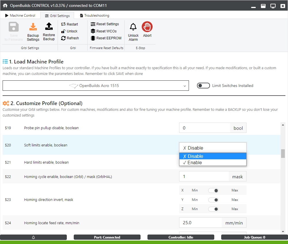

  11. Blacksmith74
    May 17, 2024
    36
    A very noob question how do I test with soft limits off?
  12. Peter Van Der Walt
    15,699
    4,511
    Might be good to move the specifics about the Duet to a more duet-specific forum might (or properly review their documentation Duet3D Documentation). Maybe GCode dictionary
    We mainly use Grbl / grblHAL based controllers like docs:blackbox-x32:start [OpenBuilds Documentation] (CONTROL > Grbl Settings > Soft Limits > Disabled > Save for that) around here.
    Might be easier if you had one - more experts around here, its a proper CNC controller (Not a 3D printer board thats used for CNC)
    and also much easier in general (Grbl Settings editor - way easier than config files, gcodes for configs etc), example below:
