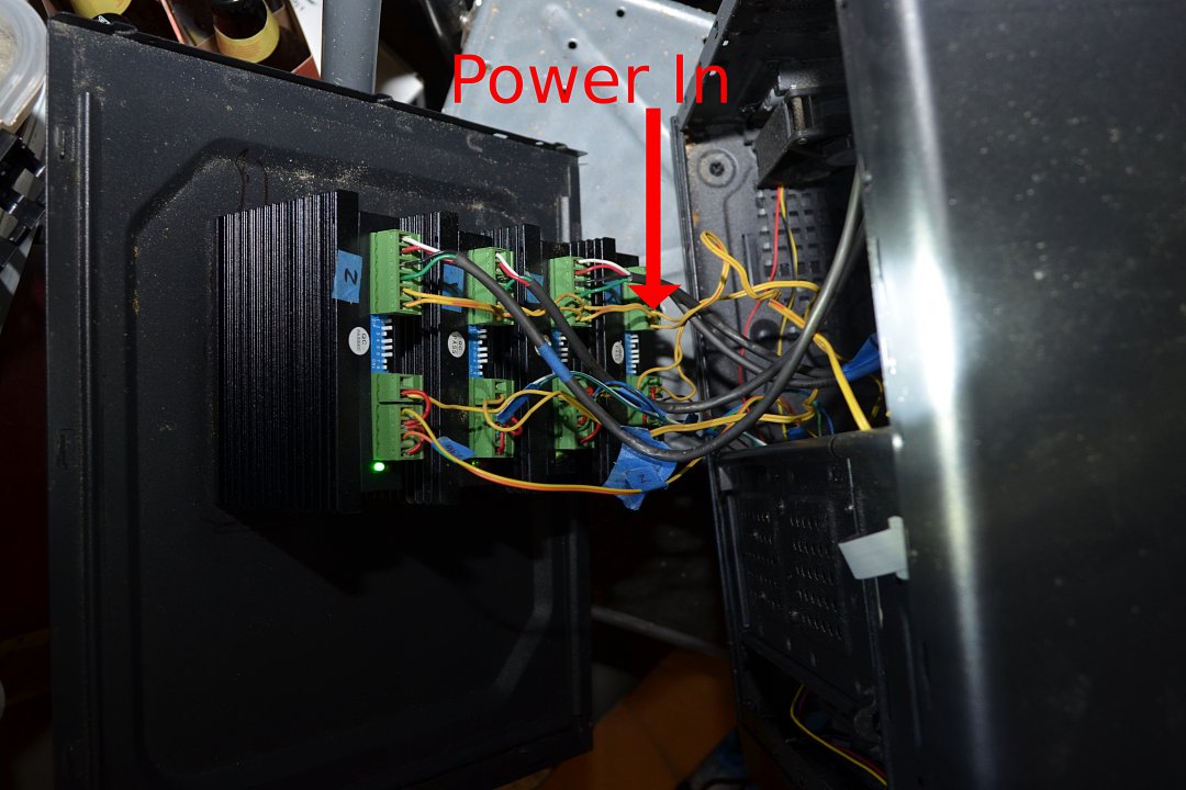

    I did take a few pictures when I built it. I mounted the drivers to more accessible removable side. I drilled holes in a 2 mm thick aluminum plate I cut for the back for mounting the aircraft plugs to connect the motors, etc...
    I did some "computer hacking" (Ha Ha) with a tin snip and made the fan hole bigger and lined it up better. I thought it was odd they did not line up. :rolleyes:
    I mounted the power supply on the opposite side/corner of where the drivers are. It is 36 V and I had some 12 V fans, so I mounted one on the side I showed where the fan hole was modified, one on the back where a fan normally goes, and one exhausting air out the front utilizing the existing fan mount there underneath where the hard drives would be mounted. I did not need three, but 3 in series plugged into the 36 V power supply prevented me from having to add a 12 V power supply, or other electronics. :thumbsup: The Arduino is mounted on the shelf where a DVD or other drive would be mounted. I used the USB port as an input from the computer to the Arduino. I spliced on the end of a USB cable on the inside where it would normally connect to a motherboard. A Google search gave me the proper wire color code for splicing. I use a headphone jack as the input port for my Z-probe. Currently the emergency off is mounted on the outside of the ATX case, but I plan to move it to the outside of the base cabinet soon.

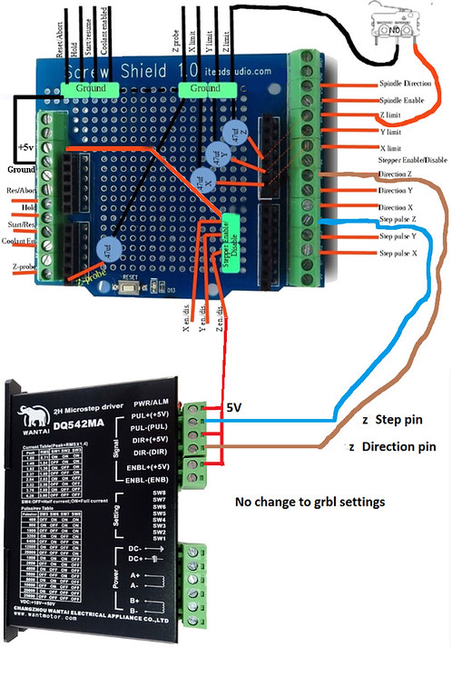

    1,703
    *Edited See this: UNO GRBL DQ542MA Wiring Methods
    Full disclosure: I am not an electronics genius by any means. I have just enough knowledge to accurately mimic people smarter than me to make things work. If it works, I stick with it. :)
    There are two ways of doing it. I chose the method where I would not have to change GRBL settings. See this post in this thread:
    C-Beam cnc
    One thing I found when doing the Z-probe was if I used the ground on the "Digital" side of the board, it didn't work. Duh! It's analog. :banghead:

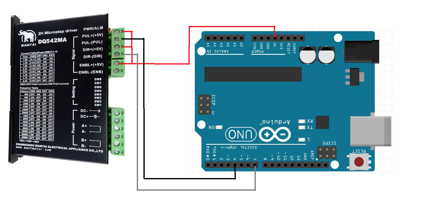

    From Kyo's build, it looks like you can use the 5V and this is how I did mine: [​IMG]
    I just followed the GRBL pinouts above and it worked.

    You had me second guessing myself, so I looked closely at my picture above and noticed no wire in the "Enable" spot on the shield.I remember having an issue with the drivers not working when I first hooked it up. Just now I went out and looked and noticed I did switch to the 5V like Kyo's picture which is why the enable spot on the screw shield is empty. I really apologize for leading you down the wrong path. I thought I had edited my build to reflect the change. I will edit the above post to correct it. Go with Kyo's drawing, it works.
    My updated wiring diagram:

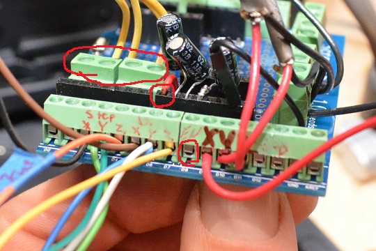

    DSC_0135blown.JPG If you look close, pin D8 has En written on it in sharpie. It is actually the 9th pin because on the digital side, the Arduino starts with pin 0 (RX0). Pin 1 is TX0. There is an empty screw terminal between the yellow and red wire.

    What I mean is the other digital pin 8 on top, where you solder on the under side to the extra screw to the yellow cable. If this image is updated, then you are connected to EN instead of 5v. I test on mulit meter the en does produce about 4.2v but the 5v produce 4.7v. I think your does work but need the right GRBL settings which I haven't setup. As long as I can swap around the cables and settings without burning anything, I am ok.

    That wire has been removed. I did not catch that in the photo. These are old photos from prior to finalization and putting it into the box. I will try digitally editing it because it would be a pain to unscrew and remove it from the control box. Thanks for catching that.
    **pictures have been corrected in this thread and in the build.

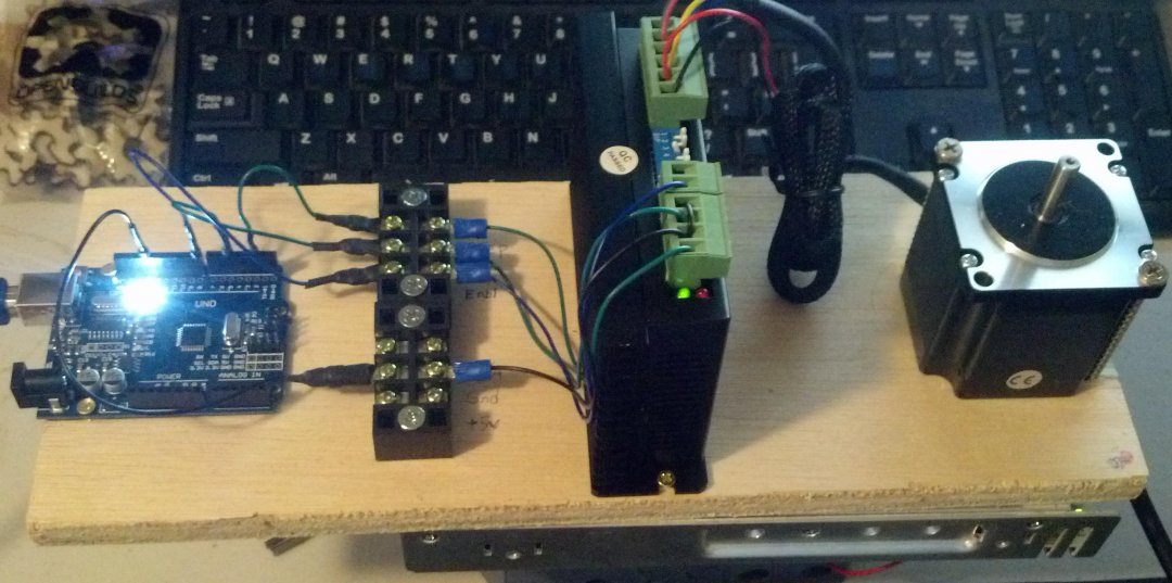

    Apologize for the slow response. I wanted to put together a bench test unit to go over all the variables as I last tested this with grbl 0.9 and we are now on grbl 1.1
    The only sound you should hear is the low hum of the steppers being energized ( this is normal ) . As you have it wired, while you will get movement from the stepper with a $4=0 setting the driver will be going in and out of fault mode. ( led will flash between red and green ) It stops working with a $4=1 setting as you have a gnd connection to the enable - terminal. As per the driver data sheet this pin must be left disconnected. Connecting this to ground disables the driver.
    grbl setting $4 should be changed to $4=1 for proper function of the dq542ma drivers when using the arduino / grbl enable pin ( other drivers may differ ) and the enbl - terminal left disconnected. The driver wants to see a +5v signal to enable and 0v signal to disable this is the opposite of what grbl does by default. The default settings is $4=0 and provides a +5V disable signal.
    I would be happy to do a updated video using grbl V1.1 and just a uno as shown in my above bench test image if it would be more helpful ( no Raspberry pi , nano combo like before )..
