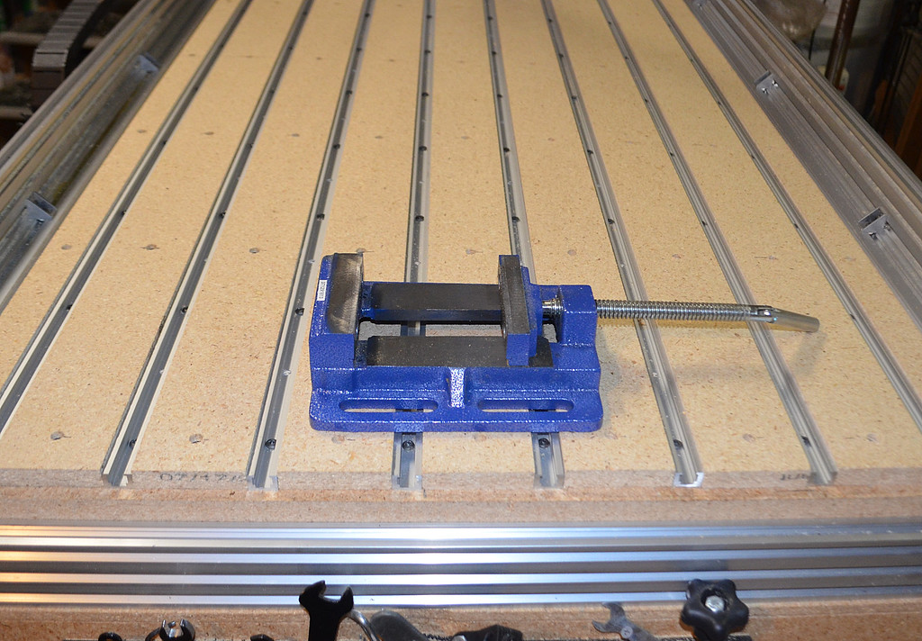

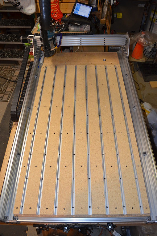

    This is my most recent upgrade, as of yesterday. I purchased a sheet of 5/8" particle board to make strips. I wanted 3/4", but the lumber yard was all out. I ripped half the sheet into sixteen 2 3/4" inch strips and three 1 5/16 inch strips on a table saw. This way I will have several spares to replace worn out strips.
    The tracks called for #6 cap head screws. I went with #6 pocket screws (which had a nice low profile head) at 1 1/4" long to make sure they would to come loose. I have two layers of 3/4" particle board below the t-tracks.
    I should be able to come up with a way to secure this vice fairly well for larger aluminum chunks, or rocks in case I go crazy and try carving them. I have bought bits to try.
    However, for day to day use, I plan to put a 90 degree corner piece in the 0,0,0 corner then I have an idea for clamps that will act like the adjustable part of a vice that can be used on the other two sides. This is why I put so many tracks on. I wanted lots of places to secure the vice part. I will try to get a mock-up done in the next few days to show you.
    I also designed a couple sizes of cam clamps with 1/4" holes to bolt into the t-track. I cut a couple out of scrap plywood and they seem to work, but it was cheap plywood so my faith is not high in them. I may try oak next. I literally have a ton of oak (or more). My dad used to build cabinets and my job was to salvage oak out of pallets. Actually, my perception at the time was that it was more slave labor than a job since no money changed hands. But the knowledge I have gained from him has more paid off. I plan to also make some out of ABS since the local Tap Plastics has a lot in their scrap bin all the time. They practically give it away where I go. The fuller the bin, the more generous they are because I was told they count on people like me (or should I say us) coming in for small quantities. I will also try with aluminum.
    This clamp is about 4 inches. I also have one that is about 6 inches.

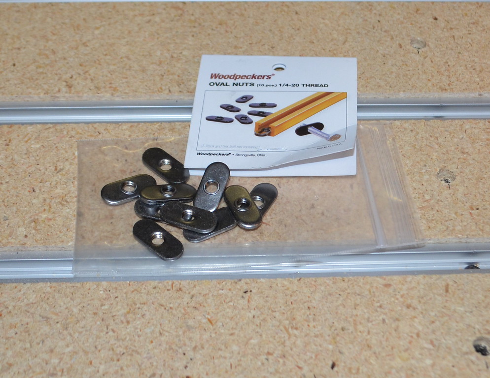

    I just ordered a Whiteside 1" surfacing bit since Woodcraft was all out. I did buy some of these 1/4-20 T-nuts from them though. I felt I had to buy something since I wasted the time driving all the way there. :rolleyes:

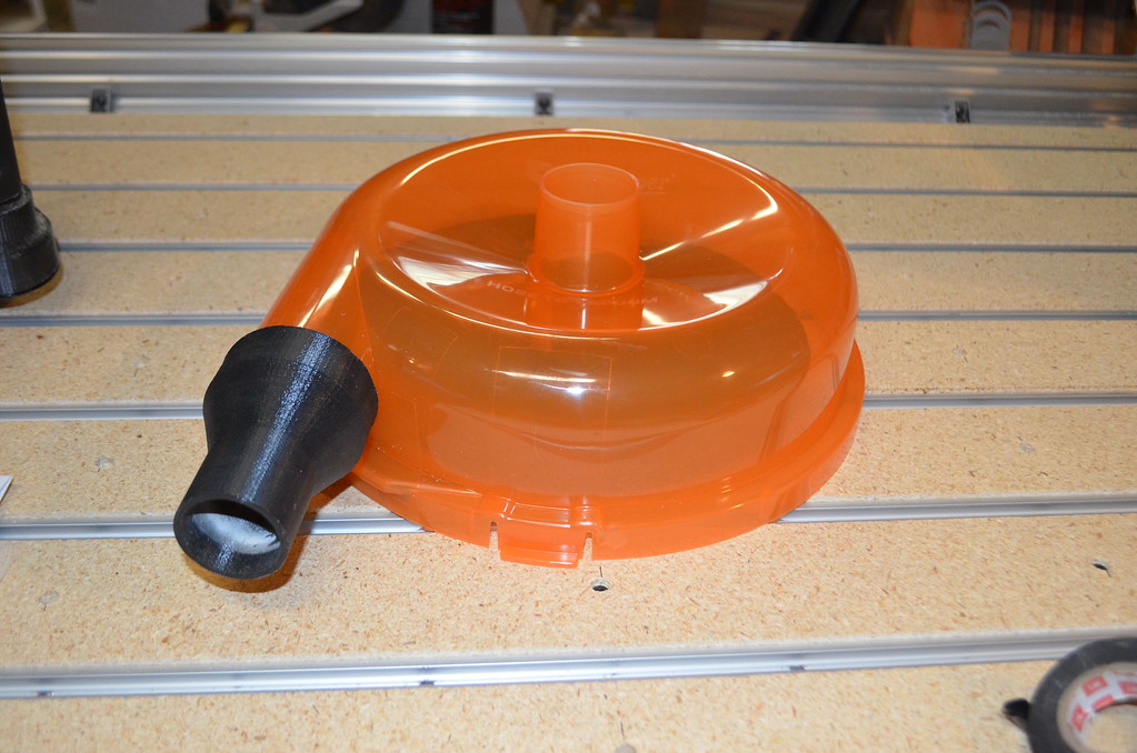

    And one of these Dustoppers to help my dust collector. I had to 3D print an adaptor though.

    Yes. It is for a 5 gallon bucket. A friend bought one and said it works great. I have been using a shop vac because my dust collector plugs due to a screen to keep out larger flakes. I want to go back to the dust collector because it is so much quieter.
