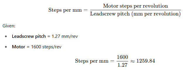

    Okay so I am a beginner and don't have much experience with the CNC systems. I am trying to build a custom system and for now I am just focusing on controlling 1-axis. And then will move to other 2 axis.
    So, I am using the Stepper Motor with lead screw: 14E17S0914FF3-250RS
    NEMA 14 Motor
    Step Angle: 1.8° and total steps per rotation = 200
    Lead = 1.27mm
    Linear Travel/Step = 0.00635mm
    Amps/Phase: 0.91
    https://www.omc-stepperonline.com/n...d-1-27mm-0-05-length-250mm-14e17s0914ff-250rs
    I have connected this motor to BlackBox X32 with latest firmware.
    Default microstep = 1/8.
    So based on my calculation, the step/mm should be: (200 x 8)/1.27 = 1259.84.
    I changed this value in the Grbl setting and the pulse width to be 100 µS.
    When I am commanding the motor to move 100mm, it is barely moving about 19mm-20mm. I tried fiddling settings but not is working and the motor is travelling way less than the desired value. Also adjusted the current in the blackbox but that won't do anything.
    Can anyone please help me what am I doing wrong or am I missing something?
    Thanks in advance :)

    only using a Y axis? is the only one set for 1259.. steps per mm, also change to a whole number (round up to 1260).

    Yes, I am only using Y-axis for now. So I have just connected 1 stepper motor at this time. Once this issue is resolved, it will connect other two axis motors.
    Update: Changed it to 1260, still it travels about 19mm for the command of 100mm

    that's a 0.9A MAX motor. BlackBox's bare minimum is around 1.2A - it will overheat and stop working shortly - that motor is far underpowered for BlackBox
    It has Lead Travel/Revolution: 1.27mm(0.05")
    1260 steps per mm is close enough
    Way too fast for such as a high resolution screw. Our 8mm pitch screws, run around 150mm/sec²
    Also quite possibly too high, our 8mm pitch screws run at 2500mm/min
    Try far lower numbers for Acceleration and Max rate, its probably stalling part way through moves
    Not even keeping in mind a NEMA14 is way less powerful than our NEMA23s, just talking about the outright increase in resolution (more precision, more torque, less speed)
    1.27/8 * 150 = 23,8125mm/sec² acceleration
    1.27/8 * 2500 = 396,875mm/min max rate
    Probably far lower because the motor is also weak
    All the way down is still 1.33 times the motors max rating (and max rating usually about 50% above recommended current setting for a motor)

    As per your suggestions, I changed the max rate to 400 mm/min and acceleration to 40 mm/sec^2 and seems like it is moving about 100mm for the set value of 100.
    But as you said that the the current stepper motor at 0.9amps is not enough for Blackbox and yes it heats up a lot. So, I will try upgrading it to NEMA 17 or 23 with higher rated current.
