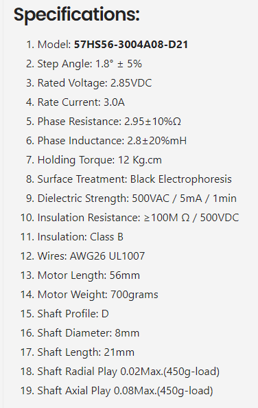

    Another question Could I use my Nemia 23 stepper motors I already have if I build a machine from like V-Slots If a can utilize some of the gear I already purchased maybe I can build a much stable working system in the near future

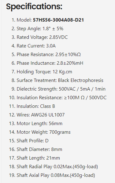

    I feel really stupid when I type questions so bare with me please, most of the information I've gathered from building this CNC was a copy and paste you might say. But these are the motors I have
    Nema 23 CNC Stepper Motor 3A 178.5oz.in 1.2Nm 57HS56 CNC Stepping Motor DIY CNC Milling Engraving Machine (178.5oz.in-1.2Nm).

    The One is from my duel Y drives, and single X drives. The other is my Z drive as you can see

    So quick google on the 57hs56-3004a08-d21
    Voltage (3) is good, will accelerate nicely
    Current (4) is good too, BlackBox will do fine with this one
    Inductance (6) is a little on the high end - will be a little lower on top speed than our motors. But as you already have them, I would say use them. Just keep in mind you may need to drop Max Rate on these about 10-15% from our profile defaults
