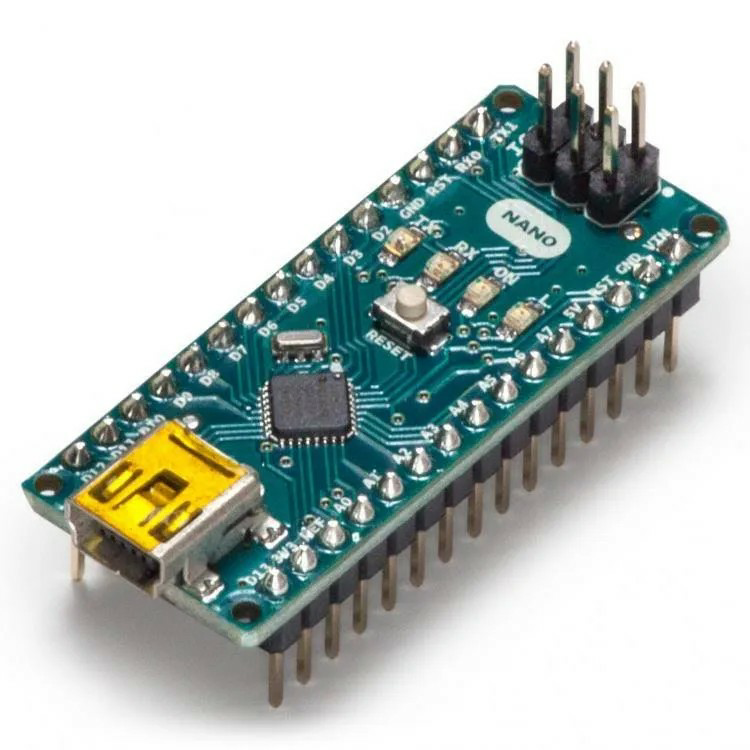

  8. LaserPhaser
    Sep 9, 2021
    Ok, I'm new here. Having a similar problem as cpu999-1! My homing is not working!! Hard to believe and somehow losing faith to GRBL !
    I try to establish my home position (....similar to X000 / Y000) at front (for Y) and left (for X)! So far so good.
    I use NC for the switches, as I read that there are some problems with the non-existing Z-axis. I have the switches connected to
    the Arduino Nano board similar to the description in the Wiki. X to D9, Y to D10 and D12 I hardwired to GND, following the Wiki suggestion.
    I changed the config.h to have only the X and Y enabled for homing - recompiled it and flashed it to the controller.
    I played arround with the values in the GRBL-List ($$). So I managed to have both X and Y travelling with $H to the front and right toward the switches!
    Unfortunately the controller does not stop with the switches and rattles at the physical stop - both X and Y. First it seemed to me that the controller ignores the switches totally!? It's half-true - as I can activate the Y-switch manually, when X and Y is travelling with $H toward the switches, suprisingly to me, X-axis is changing direction and moves to the right!
    I have absolutely no Idea any more why this is behaving so strange! In the past I have equiped my CNC-machine with limit switches - no problem at all!! Why is it so complicated with GRBL?
    Anybody out there who knows the solution!

    Hi Peter,
    thanks for your fast response! Unfortunately I have checked nearly 10 times the correct wireing of the switches! Even have put a connector between the nano and the switches so that I can unplug the switch to plug it to the other aixs and vice versa. Everything seems to be correct!
    I have a system with two Y-axis motors. The board of the nano specifies Y-1 and Y-2 plus X and the Laser connector. Honestly I don't expect the writing on the board to be wrong.
    Is there any chance that I did something wrong with the config.h? This is the only area I have no deeper knowledge and rely on the info from the wiki's. Could you think of any line of definition that could cause such a behaviour?
    By the way - I have flashed the following software to the nano : v1.1h custom XYHoming [30.08.2019]
    Hope you have an idea!
    Regards
    LaserPhaser

    I am confused. What Arduino Nano board comes labeled with stepper axis? Is this what you are using? Or is it a Chinese controller with "nano" in the name?

    Hi Giarc,
    oh - I forgot - the Arduino Nano is exactly the core of the board that also contains 2 driver-boards, which are connected to the Nano and on the other side drives two Y-stepper and one X-stepper! On this "Carrier-Board" the connectors are marked with Y-1, Y-2 and X! Also the connector for the Laser is on that carrier!
    Sorry for being a bit unclear!
    Regards
    Laser-Phaser

  18. Giarc
    3,062
    1,716
    Now I am tracking. Thanks
