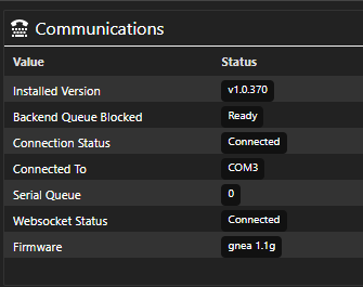

    Hi All
    My systems has not been used for few months, but since re-starting it in the last week, I keep losing my internet connection when the controller is started. The connection remains ok with just the software running , but the moment I turn the power on to the controller, I lose my connection. Once I turn the controller power off, the connection returns.
    Note - I don't get any error / IP conflict etc showing on the screen.
    The set-up is as follows:
    • Blackbox Controller - v1.0.370
    • Ethernet connection via TPLINK (pass through power line adaptor TL-PA4010P)
    • Connection status when internet connection is lost - see attached file
    I have tried multiple combinations of connections to the USB ports, but all give the same result.
    Any ideas?

    Try a test without the powerline ethernet adapter. Those tend to be quite flaky around machinery, switch mode PSUs, spindles etc.
