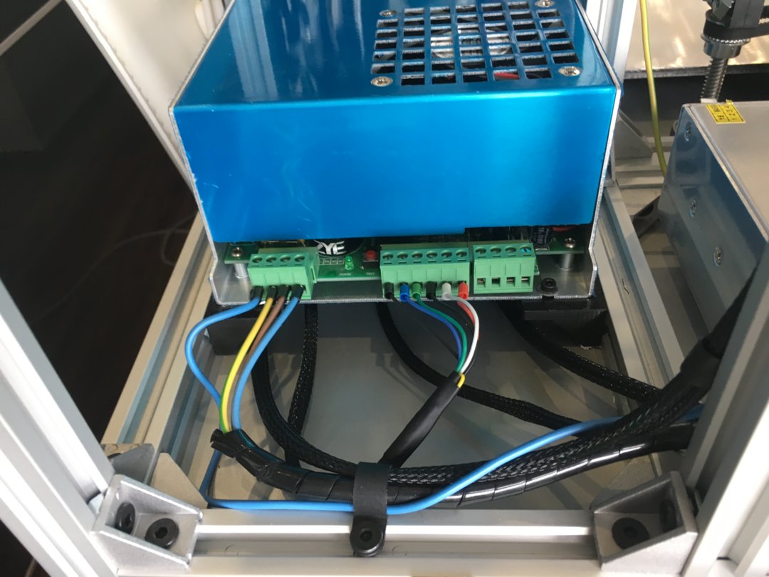

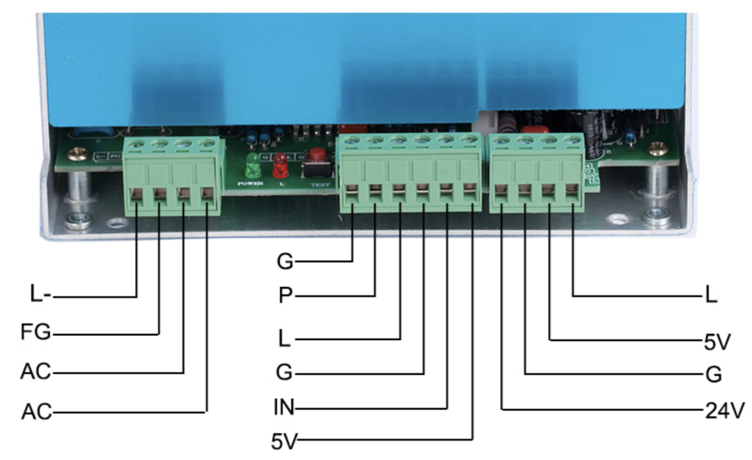

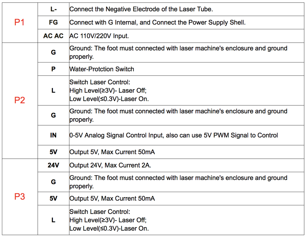

    Hey Jorge. This is the part I've been struggling with a little bit as well. As written somewhere above I don't have and won't any schematics. At post #10 you have some guide fot the wiring.
    Regarding the connection to high voltage PSU.
    G - is obvious, that is connected to ground of controller board. On the photo you can see that there are two black wires connected despite they are bridged inside of PSU. One is inboud from controller, the other is outbound for level shifter.
    P - the blue one, is water protection switch. This one must be connected to ground so the laser operates. You can bridge it to ground directly at PSU. I have wire back to controller, so I can implement this feature in future. In config you can see that pin 2.11 is bound to ground permanently.

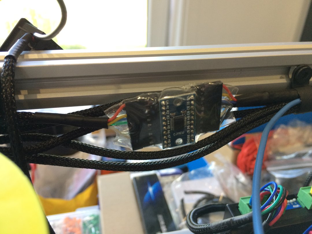

    L - green wire, is laser control switch which accepts 3 volts. This one is connected to 2.12 as serves in Smoothieware as laser TTL pin. Because of this pin there is 5V<->3V level shifter between PSU and controller.
    IN - white wire, is the pwm control of the laser and is connected to 1.23 pin of controler board. This one is 5V compliant and thus is not connedted through level shifter.

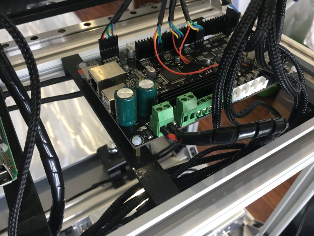

    5V - red wire, this one is 5V rail provided by PSU and is used to supply level shifter's 5V side. (Do not mistake with red wire on controller board, DO NOT CONNECT those together, see below)
    Yellow wire from controller board despite it is connected is not used - just a reserve.
    Red wire from controller supplies 3V to level shifter. Red wires from controller board and PSU go to respective side of level shifter 3V (controller board) and 5V (PSU).
