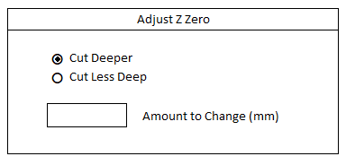

    Woud a JS macro expert be willing to make me a macro? Here's a bunch of info to explain & support:
    I need to be able to change the z position through CONTROL. Reason: I zero to the wasteboard and usually cut full sheets of acrylic that cover the entire wasteboard. Often I'll find that Z0 isn't ideal... it's either not cutting quite deep enough & leaving a thin skin of material, or it's cutting a little too deep & cutting off my tabs. If I can change Z0 I can recut the sheet & save the parts. But I can't zero to the wasteboard with my touch plate because the material is in the way.
    My current solution is a line of code entered in the serial console. I move to a known Z height (for example, 40mm) and enter this:
    G21 G10 L20 P0 Z40.2
    This tells the machine that the current position is actually 40.2mm away from zero, .2mm farther than it had been so it'll cut .2mm deeper. It works, but I have a helper who runs my machine on large jobs when I'm at real work. I don't want him entering code or anywhere near the serial console. I'd like him to have an easy & intuitive way of doing this though.
    What I'd like is a macro that presents a dialog box asking how much to adjust Z0. It can be in mm. It could have two choices... "cut deeper" or "cut less deep" and a field to enter the value. Or if having two choices is too complicated, it could simply be two macros. One to cut deeper, one to cut less deep.
    A simple example of the dialog is below. Fingers crossed... thank you.
  2. sharmstr
    2,059
    1,449
    Doable, but in the meantime, just create a macro that sends the command and edit the Z value before you run it.
    Also another reason why I miss the ability to type the new value in the dro :(
