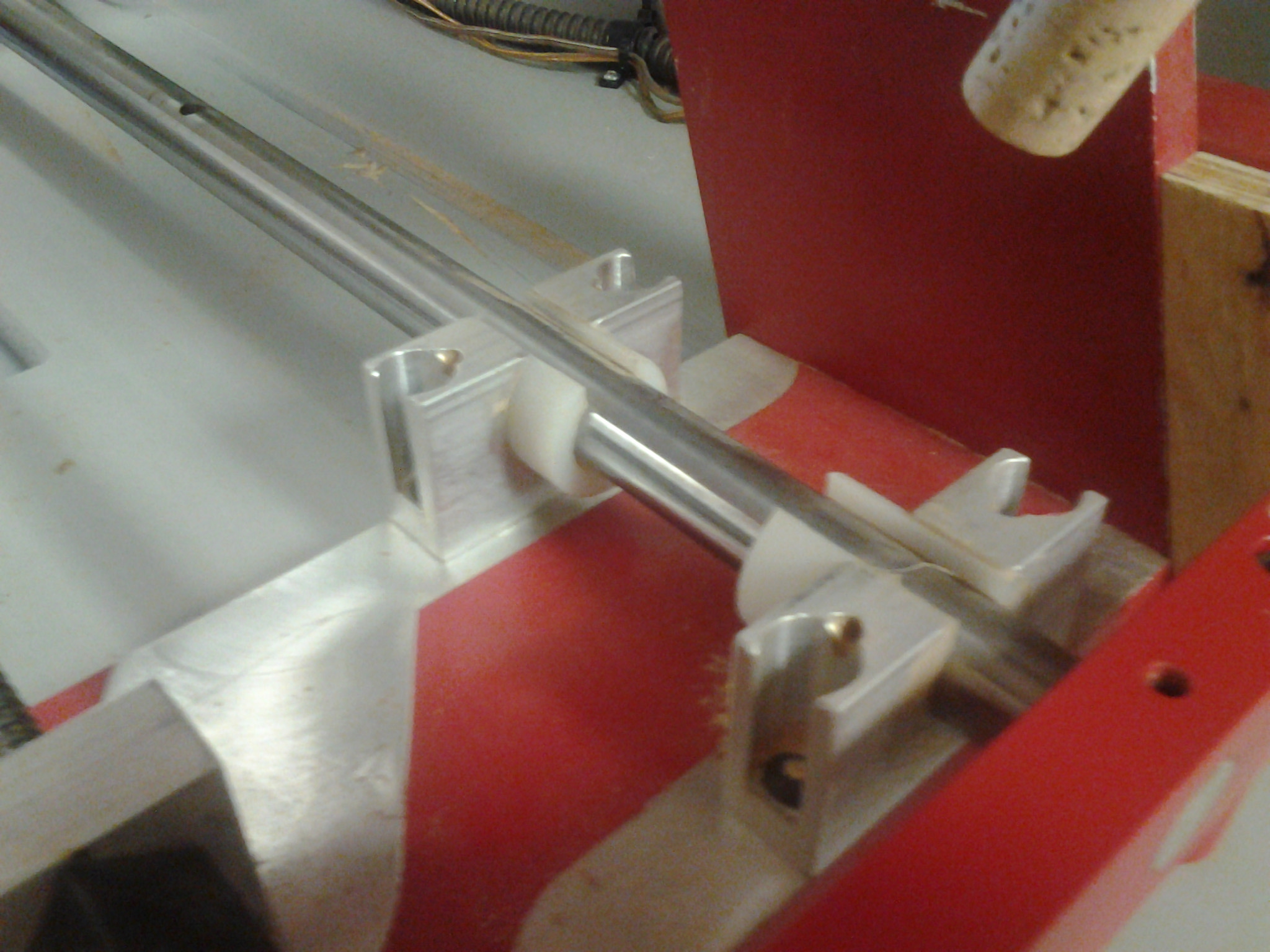

    I found two "hidden" screws that I had to remove before removing table from the machine. The plastic bushing are sized like this:
    1" inside diameter
    1.55" outside diameter
    1.75" long
    5/8" cut from top of bushings
    I have five choices:
    buy new bushings or have them custom-made.
    replace bushings with linear bearings
    replace old machine with new one such as LEAD Machine
    don't use the machine in the shop and use my machine at home
    bring my machine from home to shop

  8. jeffmorris
    jeffmorris Journeyman
    Nov 6, 2017
    496
    115
    Note the space between the rod and the bushing at the bottom. I would 3D print new bushings but I don't know exactly what kind of plastic filament that I need. The rods are hollow! I thought that the rods are solid because of the ends of the rods. Any suggestions?
  9. Rick 2.0
    2,893
    1,552
    You might talk to igus and see if you can get a sample of their iglide filament to try out.

  11. jeffmorris
    Nov 6, 2017
    496
    115
    The bushings came today and they fit my machine perfectly (one was a little bit too tight). The hardest job was installing the two "hidden" screws that go through the shaft, the spacers, and into the platform.
