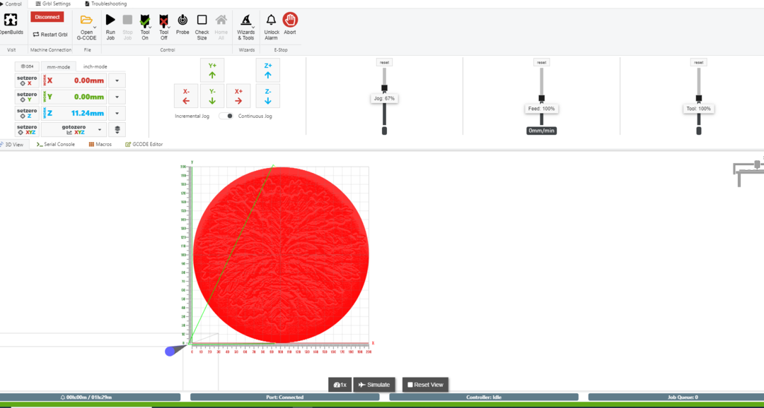

    I'm doing a project which involves creating a 3D profile with a program that has over 200K lines of code in it, however it fails to run.
    I'm using a Blackbox motion controller...and all my other router programs have the same Gcode at the start and the end of the programs and all work fine.
    Is there a max number lines of gcode allowed in Control?
    (The program was created on Aspire)
    Any help would be appreciated!

    As far as file size goes, it dependent on the computer you're running Control on. If you're computer is struggling, you can disable 3d viewer in the troubleshooting tab.
    But, you mentioned, "my other programs have the same gcode at the start", which make me wonder what "fails to run" means. Are you getting an error message or is the file just not loading.

    Hi,
    My computer doesn't struggle - (i5 , 3.2GHz, 12 Gig RAM)
    After clicking Run-job ..nothing happens..the Run-job icon does not change to grey, the 'Stop' icon does not change to black and there's no noise from the steppers.
    Screen shot below after clicking 'Run Job'

  5. sharmstr
    2,059
    1,449
    Restart Control (right click control icon in systray)
    Disable 3d viewer
    Load the file and click start
    What happens?
    Builder Resident Builder
    15,700
    4,508
    Not a lot at all
    Sadly you cropped your screenshot so we cannot see the version number we show on the window's Titlebar that's been cut off in your crop - always screenshot the whole window please
    I am guessing you are not on version 1.0.330? Always make sure you are up to date (v1.0.328 had a bug so thinking you maybe have not updated to 1.0.330 yet)

    same error ...

  9. Andy H
    Andy H New
    Jun 4, 2014
    Just updating to 1.0.330...
    Will re-try after that...

  11. Andy H
    Andy H New
    Jun 4, 2014
    That's fixed it..!
    Machine cutting away now :)
    Thanks!
