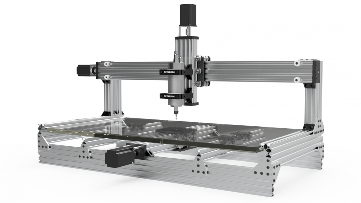

    Some more renders with all new design changes. Design@2 v4-1.png Design@2 v4.png Design@2 v5.png Design@2 v7.png Design@2 v9.png Design@2 v10.png Design@2 v11.png

    Nice work. The only thing I can suggest would be moving the Y-axis rails inward 40-50 mm to reduce the span of the main plate. This will help reduce flex in the plate and make it a bit more balanced.

    Thanks Rick. Y-axis rails moved 50mm towards the centre and is looking much more balanced and strong.

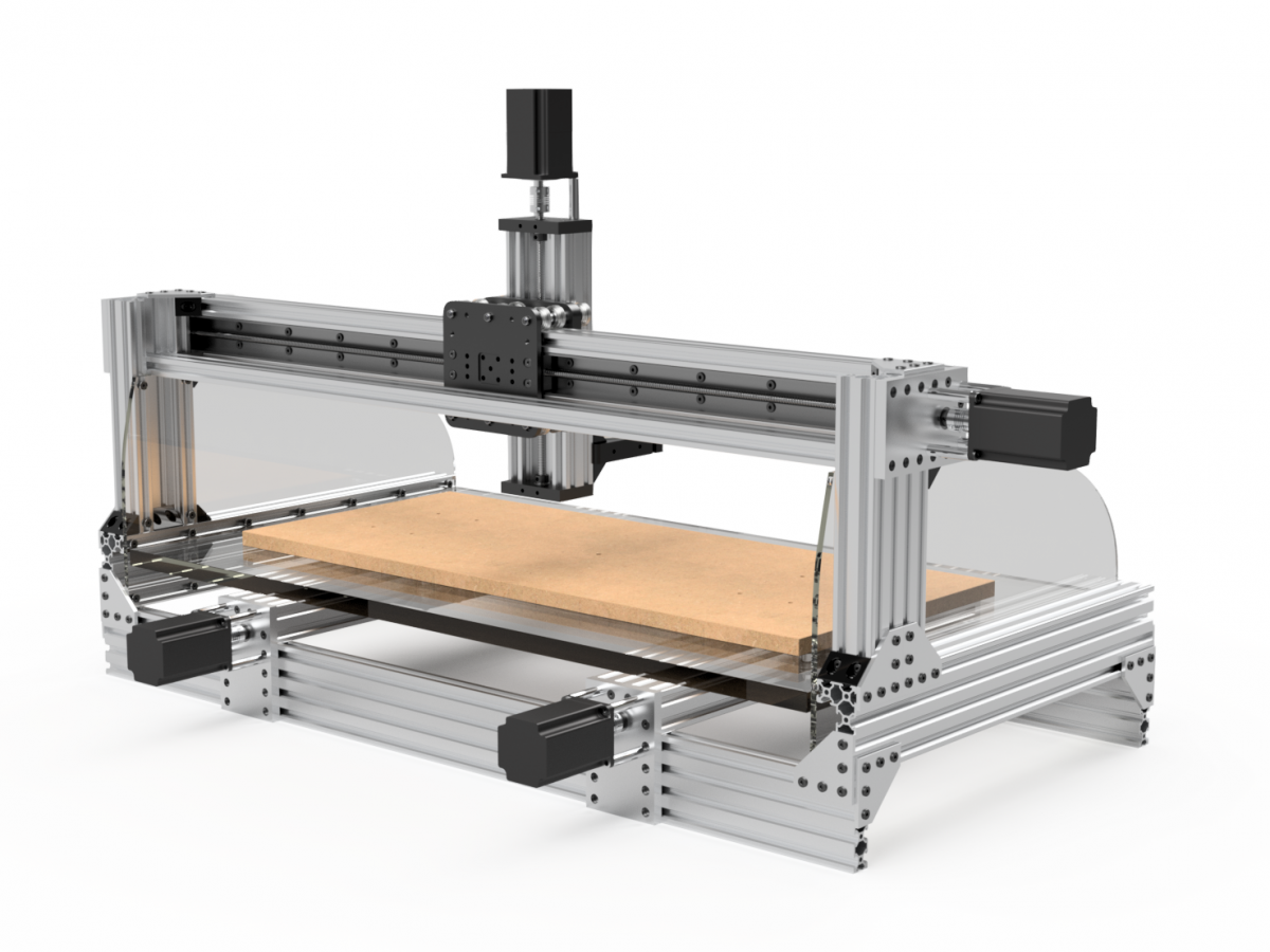

    Cheers @GrayUK. Finished design for the Side Guards / Braces. Think I will use 6mm thick Perplex mounted with 10mm M5 low profile screws recessed down 2mm. Changed my mind from having them on the outside and brought them to the inside, so I don't have to move the 90 degree plates. Had to add some conical curves for looks;)

    Is that thick piece of Perspex going to be your actual bed, or are you going to use the MDF as your replaceable bed?
    Personally I would use replaceable beds, because they are going to get chewed up quite a bit, certainly in the early trial days.

    Don't know yet Gray. It would be a little cheaper then Aluminium. More then likely more stable then MDF, especially around coolants/lubricants from a mist system. So optional.

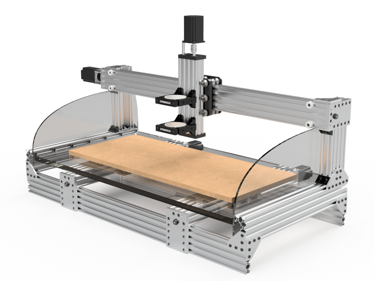

    Four more plates, two wheels and a 960mm length of 40x40mm V-Slot across the back, feeling happy how the design is coming along so far. Thank you all for the input with the design. :thumbsup: Design@2 v24-1.png Design@2 v27.png

    I'm confused about what's X an Y here! ;)

    Put a shield in the back too.
    If you want to butt this up against a wall then return the motors to the front. Then maybe use the back wall as the back shield. :D

    @Joe Santarsiero , @Rick 2.0; Being a newbie to all this CNC stuff! Here's a picture of where I think home is on this machine.
    Sorry about my limited understanding and please correct me if I'm wrong.
    X & Y positive, moves into the spoil board from this point.
    Positive Z goes up.
    X is the movement across the top beam.
    Y is the movement of the table back and forward.
    Z is the movement of the spindle, up and down.

    @Joe Santarsiero, as to using the back wall as a shield, I guess you could, just as long as the movement of the table is taken into account. It moving about 155mm front and back.
    Here's a picture of a kind of idea to help contain the chips, using some heavy clear vinyl sheet (stuff they use for table cloth and tent windows) strung from some 16mm aluminium tubing, located in notches front and back of the perplex sides. the other ends clamped down under the marine sail track, front and back of the spoil board. Sorry can't work out a way to draw it with Fusion 360, so you will have to use your imagination a little. Design@2 v32.png
