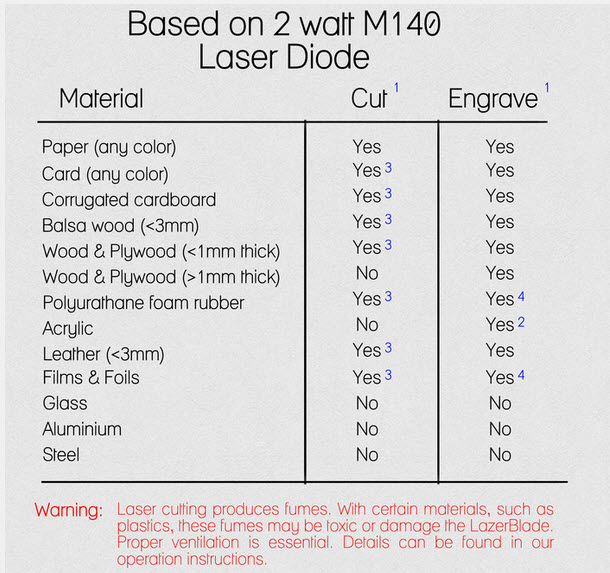

    Skarab, i like a lot your project. Have a few questions:
    Surely you can engrave or many material and cut thin ones, but what would be the max cut possible? My understanding is that it dependes on the laser power, but how do you determine that?
    My other question would be on max size. Its seem this is very lightweight as the laser does not have any friction so it would depend only on the extrusion available? What about making it work verticaly?
    My objective would be to cut cardboard, leather, vinyl, fabric and similar without leaving behind thin wood or similar.
    Your thoughts would be appreciated

    Tanks @Ariel Yahni,
    I think a vertical version is possible with a suction table or other holding system, the worry is that the cut pieces will fall and can tear apart the rest of the pieces, or get caught in the laser module.
