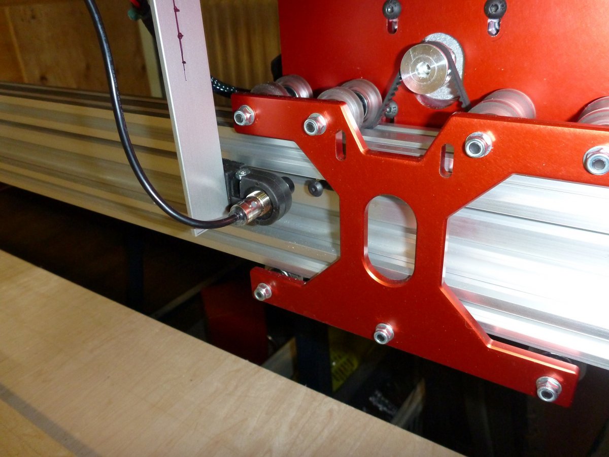

  15. Peter Oakes
    Jul 12, 2015
    25
    19
    One thing would add based on you pictures is an internal X plate to the Y gantry rails and up the wheels there to two rows as I have done on mine The Bull Dog, A RoverCNC OX based 1500mm x 1500mm CNC - Tutorial build | OpenBuilds , this will improve the rigididy of the X gantry and reduce wear on the Y Wheels as there will be more of them sharing the load

  16. Robert Bailey
    Robert Bailey Well-Known
    Mar 23, 2015
    117
    71
    yep, does make it stiffer. I haven't seen any real flex out of the Y as I did from the Z. I do have an inner plate made up if I had to go that route. I will attach it. Since it is snowing most of the office either didn't
    come in or left at lunch so I dot the mods done for the X. I haven't ran them in wood yet...so untested but all I did was expand them 20mm left and right so all the wheel placements for the Z didn't move.

    flo
  24. Peter Oakes
    Jul 12, 2015
    25
    19
    Yes you probably could quite easily, I would think all the cut outs are to reduce weight and as you can see, in my case it also allowed me to mount a limit sensor quite easilt without reducing the range of the Y axis
