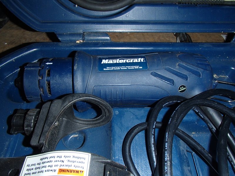

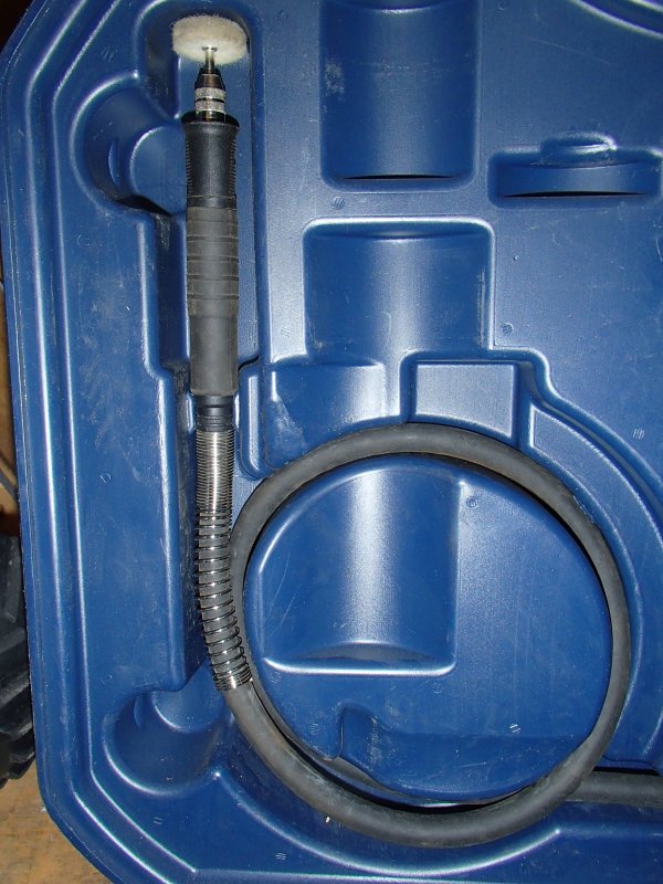

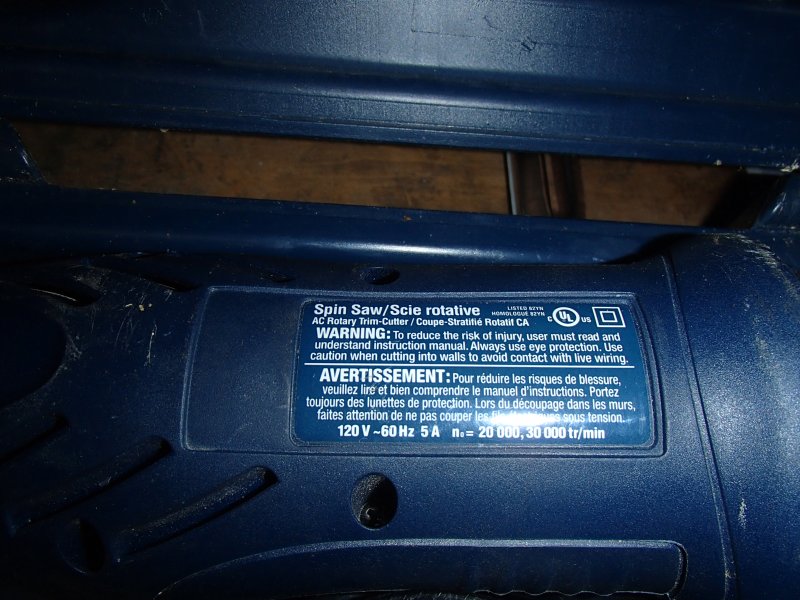

    The router was 50% off and I had some Canadian Tire money (points) to reduce price down to something like only 70$ (with taxes). It's a MasterCraft Digital Plunge-Base Router (054-6902-0) : 12 amps soft-start motor (peak 2 HP), electronic feedback to help maintain constant speed, 10k to 25k rpm, 100% ball bearing, 3 LEDs, 1/4" & 1/2" collet/nut, and replaceable brushes.
    P8242309 - myOX - MasterCraft Digital Router main body.JPG P8242308 - myOX - MasterCraft Digital Router main body.JPG
    It is a tad heavy at 2.563 kg (call it a slim 6 pounds) side of choices for myOX, but the price was right :
    P8242307 - myOX - MasterCraft Digital Router on the scale.JPG Let's hope the NEMA 17 I picked can do the job ! :nailbite:

    Yap, tool length is key ... but also the type of work being done and how the tool is held as well.
    So with the bulky and heavy router, one is definitely limited by the width of the bit end, the length of the shaft and then the bulk of the router itself as it's ... there to be dealt with. That gives, like you say, a few inches, at best, of depth.
    However, if one has a slim 'spindle' holding the tool, all that router bulk vanishes and suddenly one could get down deep ... What I'm thinking of ,not so far down the road, is using the flex extension of the (yet an other MasterCraft tool) "SpinSaw". Here, the limitation will be collet size of the tool, so smaller bits, slower work (more back and forth to cover the area being worked) yet much deeper reach. Of course, Z has also to be slim so IT does not get to be the bulk in the way. Being nice and rigid will be the challenge.
    P9172394 - myOX - a pen tool holder for fine work.JPG P9172396 - myOX - 20k-30k 5 amps should do the trick.JPG P9172395 - myOX - MasterCraft SpinSaw - the motor behind the tool.JPG
    This baby is 5 amps with speed select of 20k-30k, which should be plenty for the size of bits it can take, right ?
    Then there is the work to be done ... For now, at those depth, I'm mostly thinking of forms for thermoforming polycarbonate. As a mold, the form needs to pull out of the formed polycarbonate. So there is no overhang "alllowed". This translates to "easy" work from the top ... My target molds will be about 6-7" tall (at least the first few attempts : 1/10 scale car/truck bodies off of SketchUp downloads and my own variations). So, if the tool is in the way (ie using a heavy router), myOX's bottomless table allows for "easy" rotation of the work piece (bit of hardware to be worked out here) and work in less than 3-4" deep faces (top, left and right side doing 90 degrees rotations; bottom should be "flat" ...; maybe front and back faces, depending on the "bit of hardware" bieng worked out) even with a big fat router. They key, in that case, is having the open bottom ... I do plan in working details in the molds. Trick will be to keep faces aligned ! Time and experience will force myOX to be a continuous work in progress. So there may be a babyOX in the works before long as a go to machine for the making of parts to evolve myOX.
    Yes, I tend to over think/analyze things ...
    Oh, I'm green, so all the feedback is welcomed and taken constructively.
