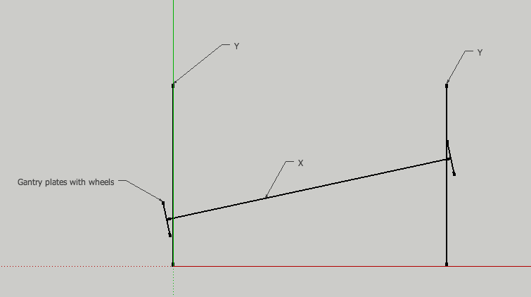

    Hope this picture will make it clear to you why your X should be square with the Y and why 1/2 inch difference between right and left can cause a lot of noise. After this you're on your own as far as I'm concerned.
    I think the sound is mostly coming from the friction of wheels on the profile, metal that gets twisted and rubbing against each other in combination with stepper motors working like hell to get the thing running.
    Keep going like this and sure something will break soon. Just my opinion.

    Thanks. I was suspecting something like that given the mechanics was getting pretty good (at least for me).
    The alternative was that I had damaged the one stepper (initial mis wiring) and/or, worse, the respective driver.
  6. Serge E.
    Serge E. Journeyman
    May 6, 2014
    730
    252
    Like they say, a picture is worth a 1000 words. The only problem is your picture is not what I've been trying to explain in my Frenglish and limited technical jargon. Sorry for the confusion. So, still without a picture, but fewer words than my previous posts, I'll try again.
    The part you are missing is I always referred to, as best as, the two BASE 20x40 not the three 20x60 of the actual X beam, ones you illustrated. Of course, the latter needs to be squared to the rails they ride on (the Y beams). However, that's not my problem.
    What I obviously did not explain clearly, is that squaring the Ys with the BASE 20x40 (not the X carriage assembly, as shown in your sketch) is, at least in my situation, the worse thing I can do. This is due to fact that both sets of opposing sides are NOT quite equal in length (I should of measured and adjusted ALL lengths - the ones I cut AND the factory cut lengths, BEFORE the assembly process.
    Think of building a cabinet frame, a table base (legs+frame) or a perfect cube. Measuring the diagonals is a MUST to square the shape as the opposite sides must also be of equal length. But this squareness does very little for aligning the doors or the table top (yes, it helps if reference point is the frame, but most of the time that frame ends up out of sight and alignement of doors is done with respect of all other doors, etc.)
    Now think of a set of railroad tracks or the tracks of a roller coaster. As long as these rails being rode on (our Y) are parallel, does it really matter if the spacer beams (railroad ties) are of exact equal length or even dead on parallel with each other, the first to the very last thousands of feet or even miles away ? In fact, especially with roller coasters, those 'spacers' holding the rails equidistant form each other (ie parallel) can and do get into sometimes weird shapes and angles.
    This is my situation : to try and square the BASE (the two 20x40 with the 20x80 Ys, which together form the base frame of an OX, including myOX) is not as useful as one might be lead to think. Yet, as shown in one of the videos, "squaring" is shown as forcing two opposite corners of the BASE to make IT square. What MUST be SQUARED is EXACTLY what your sketch show : it is the X carriage/assembly to the two Y support beams.
    As such, we are both right BUT talking about two very different aspects of these builds. Sorry for the mass confusion possibly caused by my Frenglish and limited technical jargon.
    By not getting OCD about the squareness of the BASE, I managed to get the important X carriage/assembly to Y beam nice & square. In fact, I had it from the beginning and this was not the source of my problem.
    My problem, as might of been confirmed in other recent posts, is that I'm running my steppers slightly (or a lot) underpower (at least for X and Y steppers). The Z is most likely overpowered. Again, I am using the default factory setting of the controller as it was set mid-point (ie. seemingly "safe").
    Hope this little back and forth discussion helps others as well. Next time, I'll try to include a sketch. Sorry.

  8. GrayUK
    If I may impose here, because it's getting boring. :)
    What Serge is saying, to paraphrase;
    "My Y's are parallel. :thumbsup:
    My X is Square to my Y's. :thumbsup:
    The Y's are, simply, not the same length." :thumbsup:
    That's it really, as far as I can see, and it has no bearing on the performance of the machine! :thumbsup:
    Gray
    Serge E. likes this.

    Robert's suggestion of giving a bit more juice to the NEMA 23s (1/4 turn) worked wonders - steppers are quiet !
    Almost there, eh ? Well not quite, I noticed the two set screws on the near Y stepper were not quite tight enough, actually loose ! Tightening them was near impossible. So I replaced with what I had on hand from an other project : 16 mm long set screws. The difference was unbelievable. So I changed the ones on the other Y stepper as well. The X already had one of these since original is missing from package, so I changed the second as well. The new ones are long, but not in the way of anything. :thumbsup:
    I'll get some Loc-Tite (blue) to minimize risk of seeing any of them work their way loose. :thumbsup:
    Almost there, right ? Not quite, I now see some "stuttering" when moving Y ! Turns out the weak current and loose set screws had hidden a more troubling fact. There is a lack of squareness, as Prauk was trying to point out, but it's not were either him or myself OCDed about in the last few posts.
    So I spend a few hours over the weekend measuring and doing some actual routing (to put some resistance/load in the movements).
    My two Y beams are as parallel as I can measure : same distance apart all along their 750mm or so length AND diagonals are equal, given precision of a tape measure to span the 1500 mm or so distance. Precision is thus only about 1/32" (0.7938 mm). We've seen better.
    The two Y gantry plates seem as parallel to the Y beams as I can measure, using both old and new square. Not an evident measure. They also seem parallel to each other, doing same measurement as with Y beams, taking three different measurements : centre top, centre back and centre slopped front. :thumbsup:
    So where can the problem be ?! :banghead:
    Turns out, as I had mentioned and ignored earlier, the twinned X beams are NOT square to the Y plates... As I more precisely took measurements, using the new graduated square (30 cm long) and my trusted metal ruler, there is ~3.5 mm difference 30 cm out ... opposite end of the 1500 mm (or so) length the difference is just about the same in the opposite direction. This says, although both gantry plates are parallel, they are skewed ! Guess what ? ~3.5 mm over 300 mm gives ~17.5 mm over 1500 mm and that's by how much my near Y stops shorts of the far Y, having done all the other adjustments (down from a couple of inches mentioned early on)
    In other words, looking from either Y plate, the X beam goes "slightly" right. That "slight", after 1500 mm or so becomes ~17.5 mm ! Where I was aiming for the moon, I would be way way way off ... :jawdrop:
    o_O So it comes down to the "1500 mm" pre-cut length not all being "1500 mm". In fact, in measuring the twinned 20x60 and spare 20x40, they vary from 1504 to 1505 mm. As best I can measure the third X beam without taking everything apart, it sits at 1504.5 !
    This sort of situation does not seem to surface WHEN the OX is not using full factory cut length in the X axis, which seems to be the case for majority of builds seen to date (not that I look at every single one).
    So my idea of minimizing cuts by using full length pre-cut at the factory was NOT a good idea, especially blindly trusting they would come out perfectly "1500 mm". So far, all of the lengths I received are closer to 1505 mm (bad) then 1500 mm, none shorter (good).
    Measure ALL your V-slot lengths, pre-cut or home cut ! The error is mine, not measuring, not the factory, they do large batches and guarantee only the minimum length (by going a bit over spec'ed length).
    I now have to separate the Y plates from the 3 lengths of 20x60 (X axis beams) do one of two things :
    1. see if I can be lucky by just reordering the 3 lengths to have the slight difference in lengths work for me instead of against me
    2. or MAKE the three of equal length ... as in doing a precision cut (I have plenty of spare to still keep target 48" working width)
    The second is what I should of done in the first place ! So back to square one, no pun intended :blackeye:
