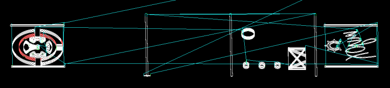

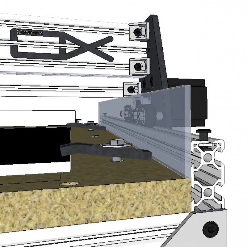

    Shields up ! Here is first public draft of the plexiglass pattern to make a shield which will wrap about the Y gantry plates (of at least myOX). You could always work from the base and do one for your own OX, if using Chris' plates.
    So I've being "playing" with SketchUp (Make 2015) for a bit now ... Putting up with some of its odd behaviour - maybe from me just experimenting rather then reading the documentation (I have looked at some videos), but I'm managing my way through it. Nice program, especially for the price (free !)
    Next step is to convert to g-code. I could use SketchUcam with just inside and outside cuts, along with fold cuts, but I really want to see what it does with generating "3D" g-code.
    I have not yet cut the 'new and improved' shield (see attached SketchUp file), but thought I could share and, especially, see if any one spots any problem before I get myOX working at it (first on a piece of scrap wood, then on the target plexiglass). The ones on myOX (see past pictures), where handmade on a table saw a while back (third attempt was the good one). CNC version should be much cleaner and shareable.
    Note the target material will be 1/4" plexiglass/lexan. I'll work just one side (for now). So things like the myOX "logo" benefits from the transparency of the material. It will be 'frosted' in contrast with rest. So it is also 'mirrored'. Once I get to a two sided job, it could be engraved on the outside face ("bottom" view of current file, sorry) and filled with paint (ie. coloured plasti-dip ?) The three round holes are for the 'abort', 'pause/stop' and 'resume' switches. The fourth larger round hole is for the "Emergency Stop" button, although it might be wiser to have this one mounted to the table ... I am thinking of having a 2nd one at other end of myOX. The rectangular hole is for a two line display (volts/amps; not certain what I'll plug it too to be of any use). While the opening for the fan is generous, with a tiny bit of 'style' (I'm no artist and I didn't want to copy/paste from others), I do plan on having a filter mat sandwiched between the fan and the opening so I don't suck in dust/chips (nor the mat hopefully). The 'slots' are to hold the controller board support. Yes, I need to 'drill' a few holes for few screws (no glue so I can take things apart). And obviously, there are the fold lines - as wide as the material is thick and 1/2 as deep to get a nice clean bend under the heat gun.
    I'll film the cutting, probably do a 'build' for it (or would it be a ressource) and also do blurb on the bending as requested a while back by some (ok, just one or two myOX 'followers'). Since I'll be back at work, it may be next weekend before things show up ... However I do want to start regular use of myOX, so I could turn this around sooner than later.

  11. GrayUK
    Serge. I would be interested to see a video of you bending the Plexi.
    Any chance?
    Gray

    The shield is already a (beta) ressource here.
  13. Serge E.
    Serge E. Journeyman
    May 6, 2014
    730
    252
    Definitely. I just have to CNC the part ... I'm hoping tomorrow after work, if I can get off earlier than usual. So the video will definitely follow shortly thereafter (just don't expect a Spielberg production).
    With the 'folds' and a good heat gun it is relatively easy (especially the 90 degree bends). Keep an eye on the ressource (I just created it). The bending will probably be 'repeated' (or linked) as a tutorial as well.

    Well, it hit me earlier in the week ... a revelation of sorts.
    In CAM there seems to be too options :
    1) The first is along the lines taken with SketchUcam - one pretty well optimizes the tool path and thus the job time, tool wear, etc. by pretty well hand picking the areas being machined. You tell it to do an inside or outside cut for this 'curve' or that 'pocket' and drill holes here and there.
    or
    2) the CAM software, like MeshCAM, "simply" goes back and forth, offsetting the parallel paths of the tool which covers the entire surface (!), occasionally lifting it above the piece being worked on and doing a rapid to an other part of the surface.
    More on this revelation in the resource : myOX Y gantry plate bent plexiglass dust shield (trying to keep things close to most appropriate build/resource).

  22. Rick 2.0
    2,912
    1,577
    A thin plex or fiberboard shield running along the edge may be just as useful as reversing the plates to protect the belt.

  24. Serge E.
    Serge E. Journeyman
    May 6, 2014
    730
    252
    Well, as you would see from post in the ressource myOX Y gantry plate bent plexiglass dust shield I flattened the layout from the orignal 3D and used SketchUcam to do pockets, traces and whatnots, tweaking generated "paths" to get rid of a few ... unruly areas by editing segments.
    I just could not go to bed without seeing what SketchUcam would do, especially since I tweaked and played a bit of shell game with it... Taking a peek at the resulting G-code with Universal G-code Sender's viewer I get this :
    Get the full post over at the resource linked at beginning of this post. Yes, it is missing the outer cutout to separate the shield from rest of raw material. But, this is looking AWESOME and cutting it should only take minutes.
    If it wasn't nearly 3 am, I would run to myOX and give this G-code a try right now ... on a piece of scrap wood ... but I have to catch some :sleepy: before work - only a few hours away now.
