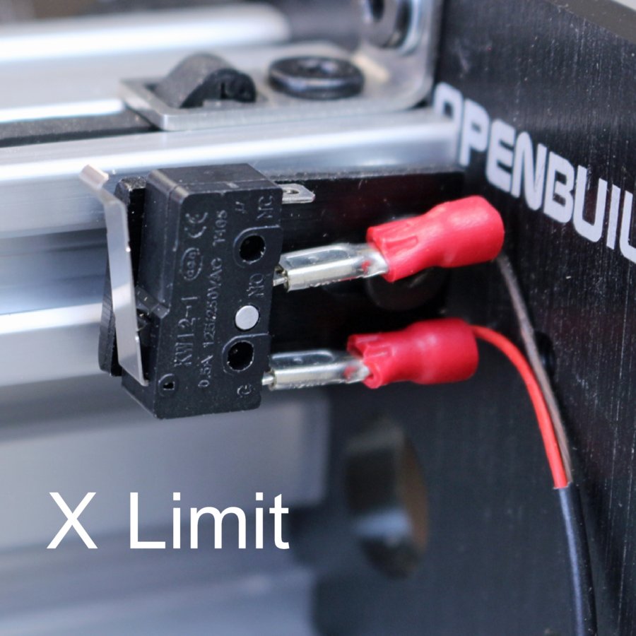

    Wiring looks OK, what about Grbl settings (output of '$$' command)
    Wiring: Check with multimeter in continuity if the far end of the wires (at controller) close with the switch (just in case of a bad crimp, broken wire, bad connection)

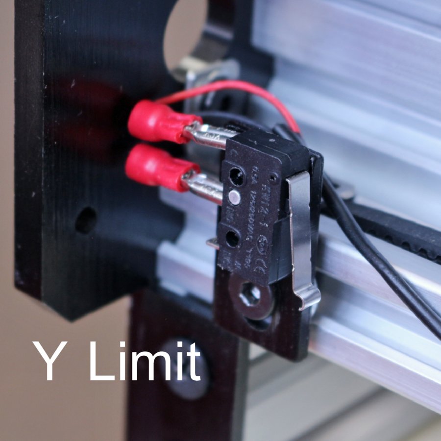

    Thank you Peter,
    Attached is a pdf of the GRBL settings on my machine. I expect to test the circuits on Monday.

    Peter,
    You were right. Both the Y and Z axis failed the continuity test in the black wire.
    Is it possible to buy comparable extension wire at the hardware store? What would I ask for?
    Regards,
    Conrad
  13. Peter Van Der Walt
    15,643
    4,470
    Awesome!
    replacement wire: Xtension Wire By the Foot
    replacement connectors: Xtension Connector Sets
    Just double check that its not a badly installed terminal/joint/etc - kinda rare for a whole length of wire to be bad
  14. Cortellini
    Jul 11, 2015
    24
    32
    It was a connector problem in both. We are now Homing.

  15. sutharvj66
    Jun 6, 2019
    hi, as per your pic red wire goes first and black goes in the middle, open build has pic of black first then red in the middle and blue goes at very end, which one is right for 3 conductor cable? thanks
  16. Peter Van Der Walt
    15,643
    4,470
    Which switch? The Xtension switch = 3 wires (colors aside pay attention to the text labels, GND/SiG/V+)
    Regular switches use 2 wire
  17. sutharvj66
    Jun 6, 2019
    thanks , i have micro limit switches with 3 connecting terminals but provided only 2 conductors cable.
  18. Peter Van Der Walt
    15,643
    4,470
    Correct. Just wire NO and C (dont connect NC terminal.
    See documentation for Micro Switches here: OpenBuilds BlackBox 4X Documentation
  19. Cortellini
    Jul 11, 2015
    24
    32
    Hello Peter,
    After much effort, I feel quite good about reporting the the Workbee is showing promise of actually being able to do the required work in the new approach to making Feedback Fractal elements that should speed the production tenfold while reducing the material by half.
    The photo shows first monochromatic results. All seemed good.
    I did some "G" coding over the weekend and came to the studio eager to produce a bunch of Elements.
    Unfortunately, for some mysterious reason, the system failed to home due to the failure of the "Y" axis limit switch.
    Here is the alarm message:
    ALARM:8 - Homing fail. Cycle failed to clear limit switch
    when pulling off. Try increasing pull-off setting or check wiring.
    [$H]
    The wiring tested ok for continuity and I checked the GRBL settings. Nothing has worked for me and the system can't seem to get past the "Y" limit switch.
    Frustrating.
    Can you lend some advice?

  20. sharmstr
    2,059
    1,449
    When the homing cycle runs, it will move to find your limit switches. When it finds them, it will move off the switch (the pull off distance) so that its not in a triggered state. Some switches need a bit more pulloff distance. So, go into the settings tab, scroll down to $27 and increase the value. Save to Firmware, then try again.
  21. Cortellini
    Jul 11, 2015
    24
    32
    Thank you sharmstr, I will give it a try.
    Conrad
  22. Cortellini
    Jul 11, 2015
    24
    32
    To anyone who still might have an interest,
    I have followed all the postings of this thread and I still am not able to home my CNC.
    I have reset all the GRBL settings and tested the wiring for continuity.
    The "Z" homing works fine. The "Y" begins the process, moves to the limit switch triggers the switch and then pulls off the GRBL specified amount. At that juncture the alarm goes off and homing aborts.
    Could the limit switch be faulty?
  23. sharmstr
    2,059
    1,449
    Not necessarily. Two things to check
    1 - With your current settings, is the Y switch being touched at all? If so, increase the pull off. Just for testing purposes you can also change it to a large value and decrease it until you go it dialed in.
    2 - If you cant get the above to work, go into the trouble shooting tab and play with triggering the switch with your finger. Slowly toggle the switch back and forth and see if you can get it to stay triggered even though you've released it.
    Another thing to keep in mind is that all of the distance values in GRBL are dependent upon you correctly and accurately calibrating the steps per mm. Have you done that yet?
    crnrstndes likes this.
  24. Peter Van Der Walt
    15,643
    4,470
    And make sure you dont have X and Y switches wiring swopped (happens quite often) - when playing in the Troubleshooting tab, make sure the X axis indicator changes when you press X, and same for Y (don't just look at activity, also make sure the activity is on the correct axis)

  29. Cortellini
    Jul 11, 2015
    24
    32
    Problem Solved!
    Wrong connection to X limit switch. The Troubleshooter helped a lot.
    Thank you for your help and accommodation.
