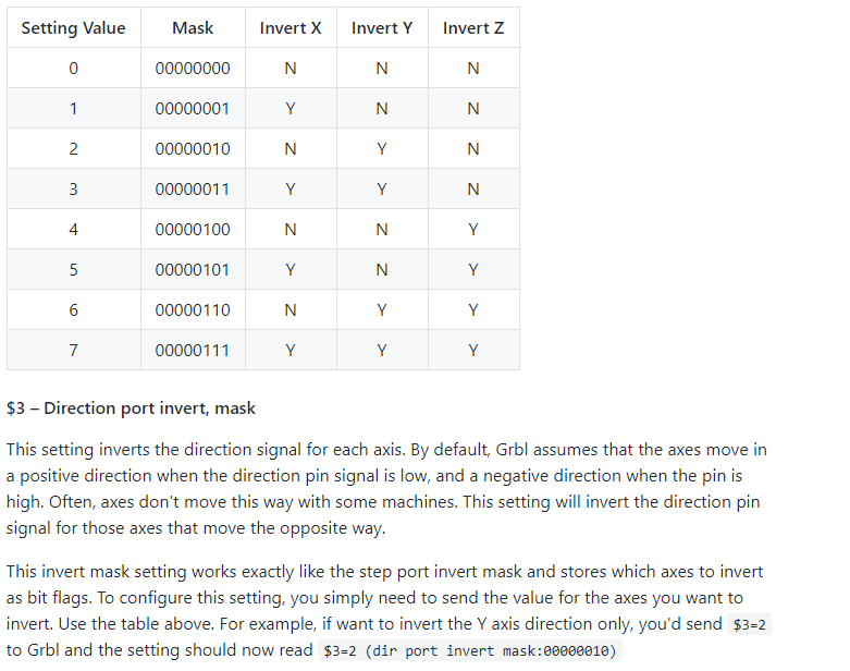

    3) Yes, you can switch the wires around of any one coil or change the direction on the GRBL setting $3.. below from GRBL Wiki...
    Make sure to read up on the GRBL Wiki and the Blackbox Docs

    @Gary Caruso: PS: In CONTROL we made it even easier, no need for a lookup table:
    Disconnect everything except power from the BlackBox: perhaps you have a short on one of the other connectors (think limit switch V+ to GND, etc) unplugging them is a quick check
    The red led on PSU going out tells me there's a short and PSU is shutting itself off to protect itself
    Almost always wiring related: Either only 3 of the 4 wires are making good contact, or you don't have the coils correctly identified (color codes could be wrong)
