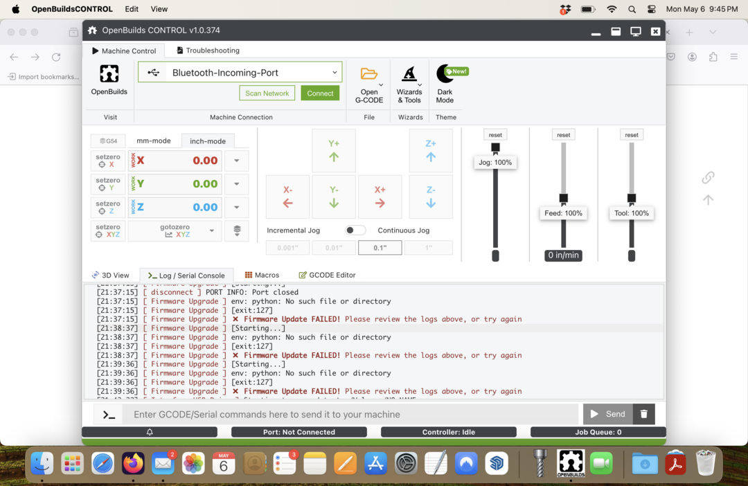

    Also, I'm having issues with the Interface updating firmware (see attached screenshot of the log). I've tried updating from CONTROL, from WiFi and from USB. The Interface doesn't recognize that the USB drive is connected when plugged in. I'm using a Macbook on 14.4.1 Screenshot 2024-05-06 at 9.45.07 PM.png [A

    Onscreen error tells you you don't have Python installed
    Or just use a Windows PC

    I don't have access to a Windows computer. I have installed Python on my Macbook but don't know what to do next. I'm not versed in using advanced programs. I think I'm gonna need a step by step how-to for getting this working with my Macbook. I've searched for such a tutorial but can't find one. Any help will be appreciated.

    According to what I've read, I need to update firmware on both the blackbox and the interface. So I've tried both, starting with interface. When that failed I thought it possibly was because the blackbox wasn't up to date - so I tried that. That's when I discovered the blackbox wasn't connecting to my Mac. Using the interface I can jog the machine - just don't seem to get CONTROL to talk to the system (blackbox).

    With the Blackbox connected to the computer with usb, after installing the latest version of CONTROL, this the the log after hitting "Connect" on CONTROL. Screenshot 2024-05-07 at 2.45.37 PM.png

    Try connecting using a Windows PC - mac can be quite finnicky
