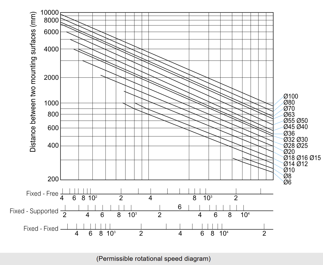

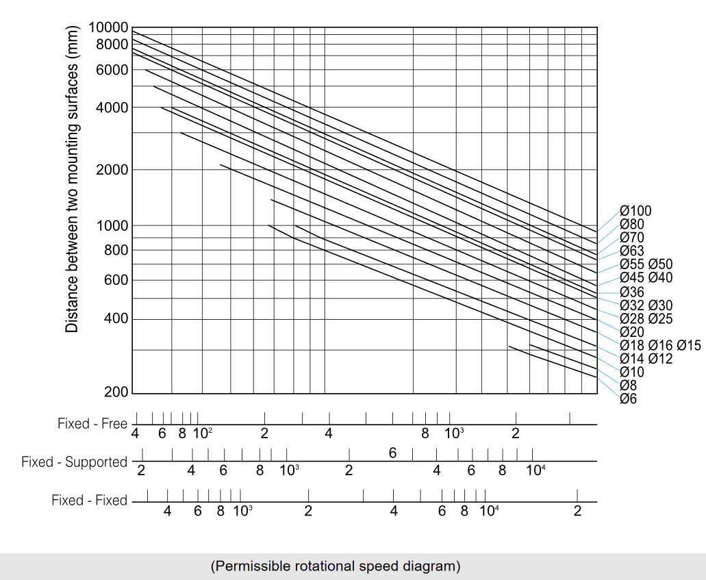

Look at the torque curves. Which has better performance at the microstepping rate and RPM range you're planning on using? Steppers are rated at max torque, which is at extremely low speeds with full stepping. 8mm lead screws definitely see fairly significant performance improvement at 1500mm from being tensioned, and would work for most hobby machines, but you're not gonna be able to crank up some crazy rapids with them. Ball screws aren't gonna suffer the issues quite as badly because their root diameters are much larger- probably about 10mm for 1204 and about 13mm for 1605/1610. It's the actual solid material in there that determines the "dangerous rotation speed". A 1605 in a fixed-fixed (similar to a tensioned lead screw setup) operation can do up to about 1500rpm. That's 7500mm/min. Double that for a 1610 screw. There's a lot more flexibility in ball screws, because they're made for so many more applications. They're great, but a lot of people have trouble with them because they don't know that they have quite precise mounting tolerances as a product of their precision nature- you really need to sweep them in in both directions with a test indicator. If you're willing to put in the work, they beat out everything for rigidity except box/dovetail ways, and those they beat on speed. Everything is basically modeling clay when you start looking closely enough- metal is soft when you heat it red hot, and it's soft at room temperature, just different levels of soft. Simulation helps, but it's a lot of work: That's one from my current build.
