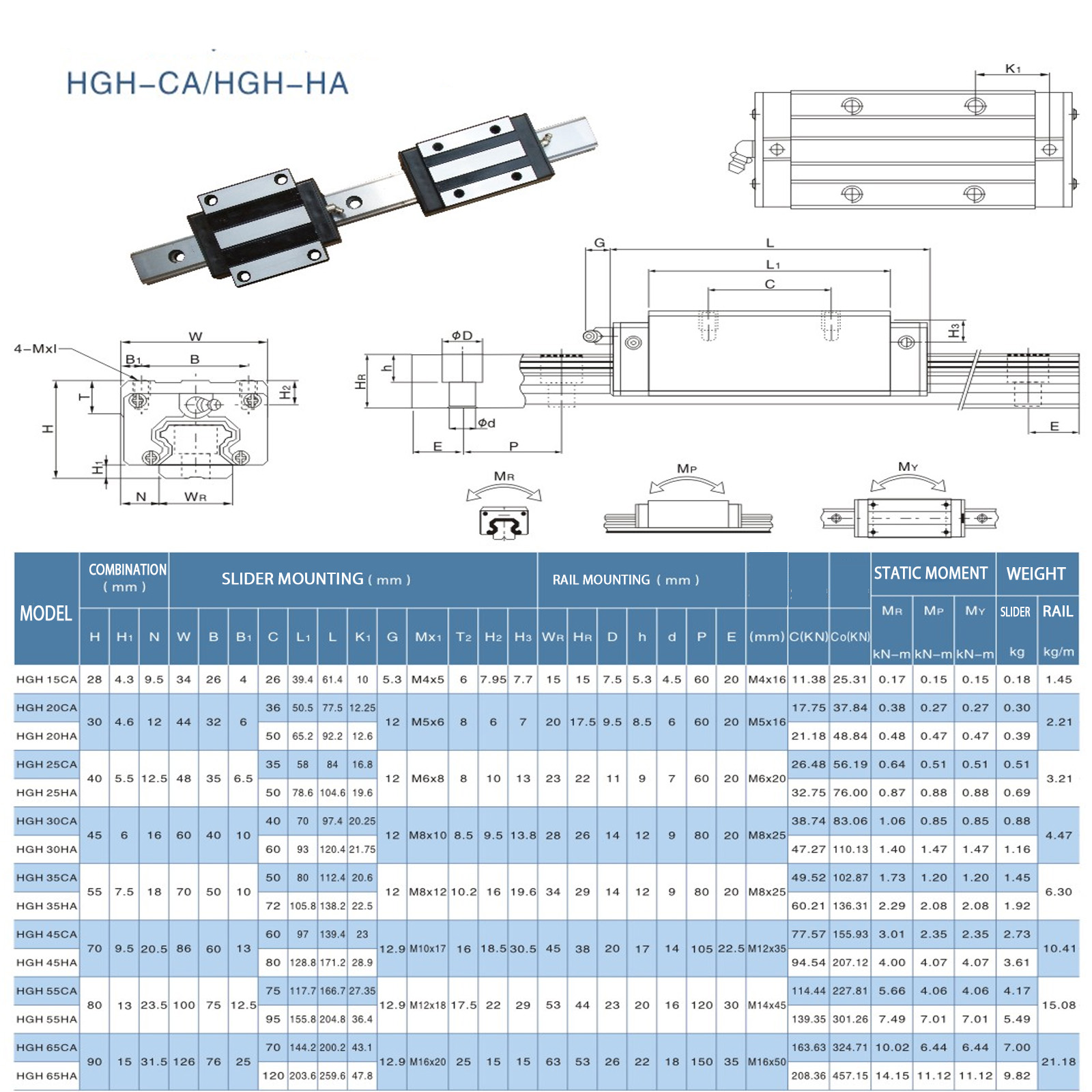

    Does anyone know where I could get a sketchup drawing of the HGH15ca bearing block, a bonus (for me) would also be how the bearing sits on the linear rail so I could figure out the distance between the pair of rails when installed on the C channel.

    Just use the dimensions and draw them up. If it were me, I would just draw a box to dimensions of the block with a slot down the center for the rail.

    I used the chart provided by Redington and built a basic drawing for that linear bearing (disclaimer - if you use it, check my drawing as I am new to this and I don't think I have the screw holes the right diameter as I did not research the shaft dimension for a m4 machine screw). I've also used the drawing of the C Channel which I found here and used it to create the basis of a side panel. I've got a bunch more to figure out and test with mdf so this is going to take me a fairly large amount of time to learn this and figure out how to put something together.

    The bolt pattern looks correct 26x26mm to the center of each hole squared and 4mm bore for M4 bolt. They look good to me.
