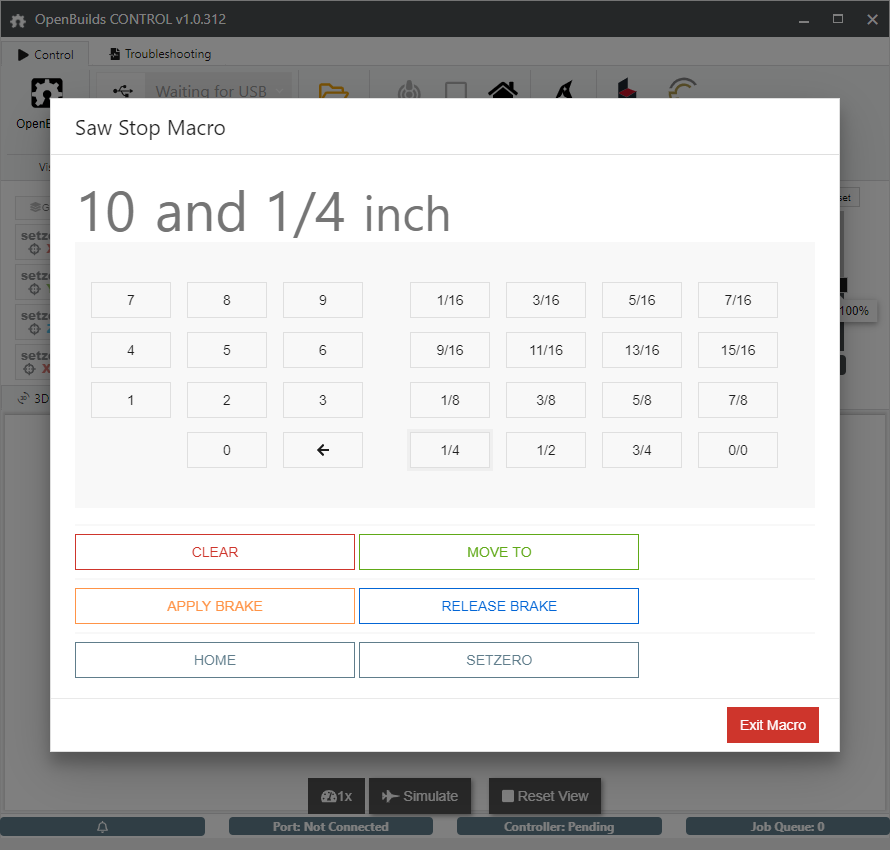

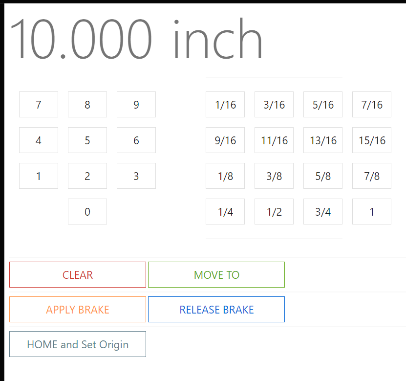

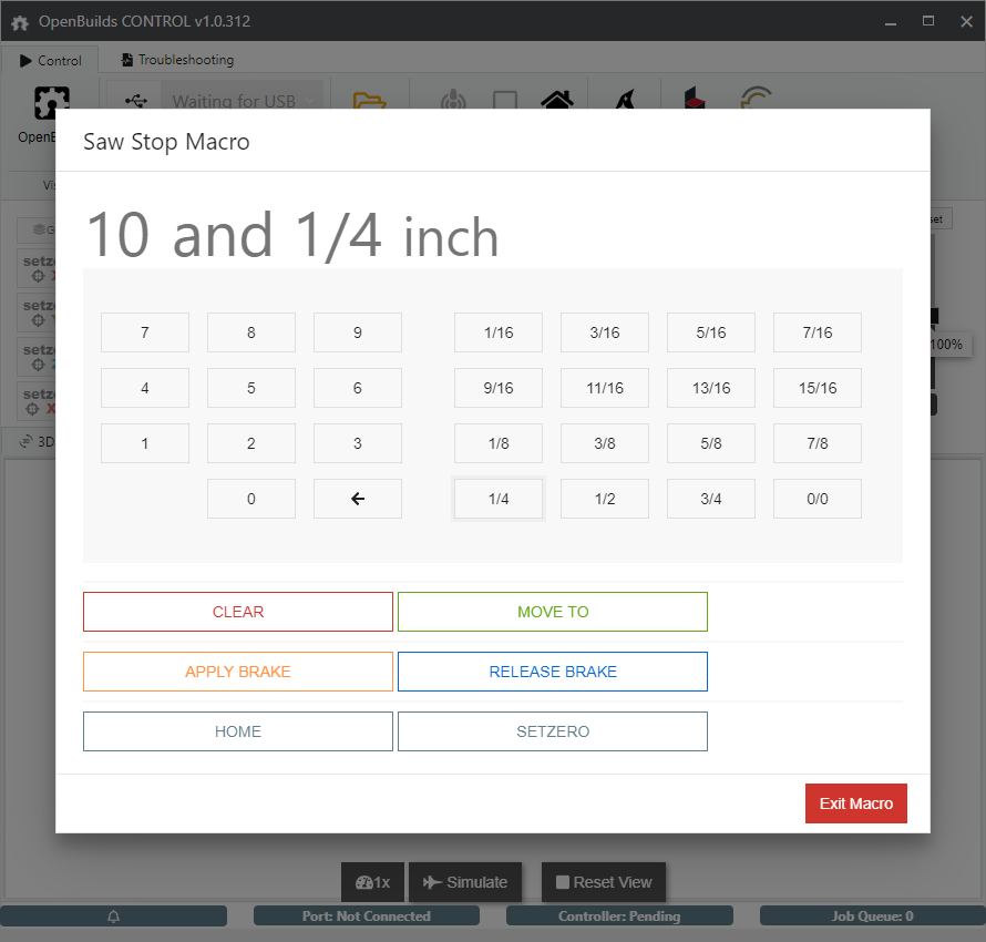

  12. Peter Van Der Walt
    Builder Resident Builder
    15,699
    4,511
    Something like this?
    #42 Peter Van Der Walt, Feb 8, 2022
  13. NickEng
    NickEng Well-Known
    Sep 10, 2020
    152
    18
    Yes exactly!
    Wow!!! So how to do I implement that to the interface?

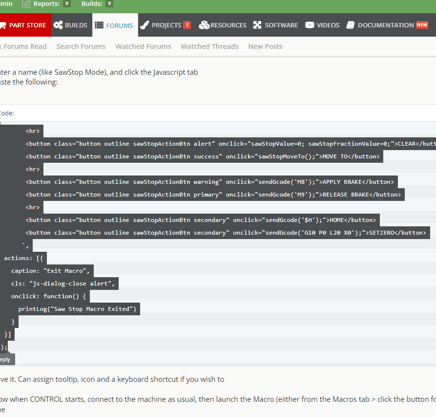

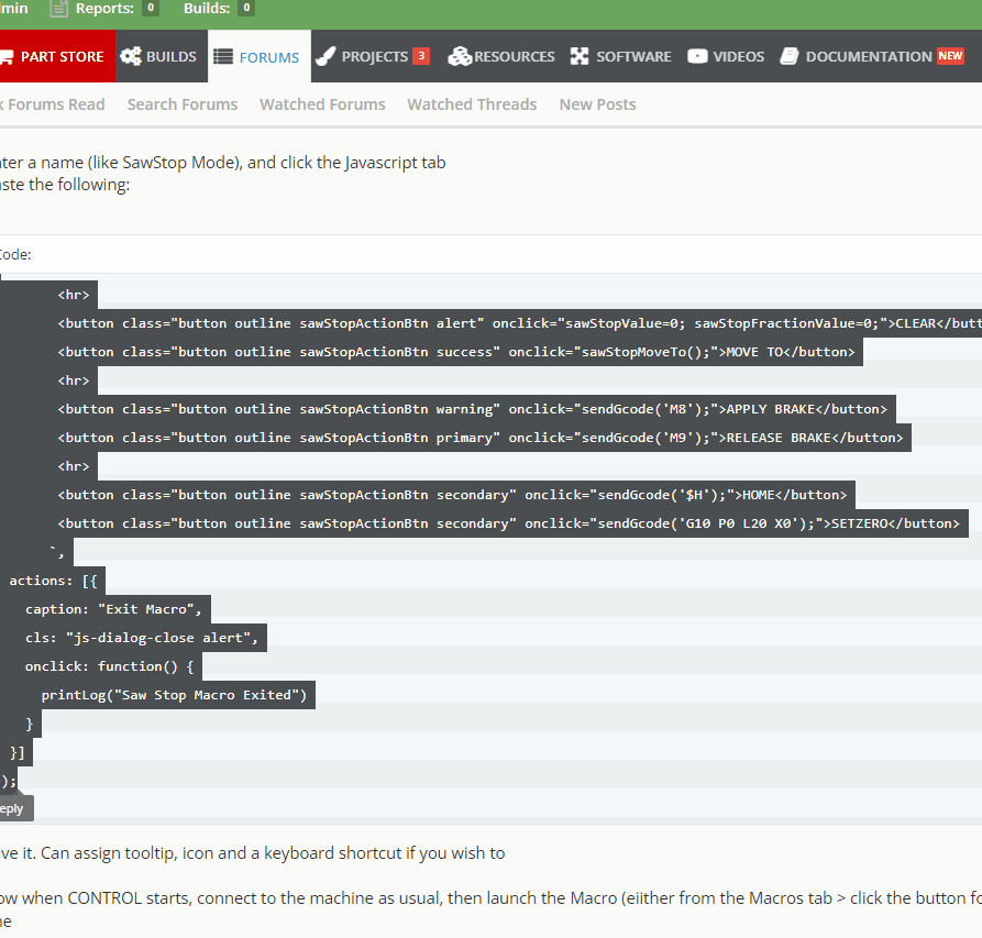

    No, Metro's already in CONTROL. You can use its elements to build GUI templates in JS, See Getting started with Javascript Macros in CONTROL / Library of Macros created by the community for some instructions and examples
  18. Peter Van Der Walt
    15,699
    4,511
    Right, not tested against a machine or anything, so consider this "draft 1"
    In CONTROL > Macros tab > Add Macro
    Enter a name (like SawStop Mode), and click the Javascript tab
    Paste the following:
    Code:
    // Add some CSS classes
    $("<style type='text/css'> .keypadBtn {width: 80px;} .sawStopKeypadBtn {width: 80px;} .sawStopActionBtn {width: 280px; } </style>").appendTo("head");
    // variables placeholder
    window.sawStopValue = 0.0;
    window.sawStopFractionValue = 0;
    // Update the UI <span> fields to display value
    window.updateSawStopValueUI = setInterval(function() {
      $("#sawStopValue").html(sawStopValue.toFixed(0));
      if (sawStopFractionValue.length > 1) {
        $("#sawStopFraction").html("&nbsp;and&nbsp;" + sawStopFractionValue);
      } else {
        $("#sawStopFraction").html("");
    }, 50);
    // keypad button
    window.sawStopBtn = function(val) {
      var currentValue = sawStopValue.toString();
      currentValue += val;
      sawStopValue = parseInt(currentValue);
    // fraction button
    window.sawStopFraction = function(val) {
      sawStopFractionValue = val;
    // backspace button
    window.sawStopBackSpace = function() {
      var sawStopcurrentValue = sawStopValue.toString();
      var sawStopNewValue = sawStopcurrentValue.slice(0, -1);
      if (sawStopNewValue.length == 0) {
        sawStopNewValue = "0";
      sawStopValue = parseInt(sawStopNewValue);
    window.sawStopMoveTo = function() {
      // Calculate Decimals from fractions
        var sawStopFractionSplit = sawStopFractionValue.split("/");
        var sawStopDecimals =
          parseInt(sawStopFractionSplit[0], 10) /
          parseInt(sawStopFractionSplit[1], 10);
        var decimalSawStopFractionValue = eval(sawStopFractionValue);
      } else {
        var decimalSawStopFractionValue = 0;
      // add decimals to integers
      var sawStopFinalPosition = sawStopValue + decimalSawStopFractionValue;
      // Send move command to Grbl
      sendGcode("$J=G90 G20 X" + sawStopFinalPosition + " F10000");
    // Create the User Interface
    Metro.dialog.create({
      title: "Saw Stop Macro",
      width: '90%',
      content: `
            <span class="display3" id="sawStopValue">0</span>
            <span class="display3" id="sawStopFraction"></span>
            <span class="display2">&nbsp;inch</span>
            <div id="sawStopNumbersUI">
            <table class="table striped compact">
            <tr>
            <td>
            <table>
             <tr>
               <td><button class="button outline sawStopKeypadBtn" onclick="sawStopBtn(7);">7</button></td>
               <td><button class="button outline sawStopKeypadBtn" onclick="sawStopBtn(8);">8</button></td>
               <td><button class="button outline sawStopKeypadBtn" onclick="sawStopBtn(9);">9</button></td>
             </tr>
             <tr>
               <td><button class="button outline sawStopKeypadBtn" onclick="sawStopBtn(4);">4</button></td>
               <td><button class="button outline sawStopKeypadBtn" onclick="sawStopBtn(5);">5</button></td>
               <td><button class="button outline sawStopKeypadBtn" onclick="sawStopBtn(6);">6</button></td>
             </tr>
             <tr>
               <td><button class="button outline sawStopKeypadBtn" onclick="sawStopBtn(1);">1</button></td>
               <td><button class="button outline sawStopKeypadBtn" onclick="sawStopBtn(2);">2</button></td>
               <td><button class="button outline sawStopKeypadBtn" onclick="sawStopBtn(3);">3</button></td>
             </tr>
             <tr>
               <td></td>
               <td><button class="button outline sawStopKeypadBtn" onclick="sawStopBtn(0);">0</button></td>
               <td><button class="button outline sawStopKeypadBtn" onclick="sawStopBackSpace();"><i class="fas fa-arrow-left"></i></button></td>
             </tr>
            </table>
            </td>
            <td>
            <table>
             <tr>
               <td colspan="3">
                 <hr>
               </td>
             </tr>
             <tr>
               <td><button class="button outline sawStopKeypadBtn" onclick="sawStopFraction('1/16');">1/16</button></td>
               <td><button class="button outline sawStopKeypadBtn" onclick="sawStopFraction('3/16');">3/16</button></td>
               <td><button class="button outline sawStopKeypadBtn" onclick="sawStopFraction('5/16');">5/16</button></td>
               <td><button class="button outline sawStopKeypadBtn" onclick="sawStopFraction('7/16');">7/16</button></td>
             </tr>
             <tr>
               <td><button class="button outline sawStopKeypadBtn" onclick="sawStopFraction('9/16');">9/16</button></td>
               <td><button class="button outline sawStopKeypadBtn" onclick="sawStopFraction('11/16');">11/16</button></td>
               <td><button class="button outline sawStopKeypadBtn" onclick="sawStopFraction('13/16');">13/16</button></td>
               <td><button class="button outline sawStopKeypadBtn" onclick="sawStopFraction('15/16');">15/16</button></td>
             </tr>
             <tr>
               <td><button class="button outline sawStopKeypadBtn" onclick="sawStopFraction('1/8');">1/8</button></td>
               <td><button class="button outline sawStopKeypadBtn" onclick="sawStopFraction('3/8');">3/8</button></td>
               <td><button class="button outline sawStopKeypadBtn" onclick="sawStopFraction('5/8');">5/8</button></td>
               <td><button class="button outline sawStopKeypadBtn" onclick="sawStopFraction('7/8');">7/8</button></td>
             </tr>
             <tr>
               <td><button class="button outline sawStopKeypadBtn" onclick="sawStopFraction('1/4');">1/4</button></td>
               <td><button class="button outline sawStopKeypadBtn" onclick="sawStopFraction('1/2');">1/2</button></td>
               <td><button class="button outline sawStopKeypadBtn" onclick="sawStopFraction('3/4');">3/4</button></td>
               <td><button class="button outline sawStopKeypadBtn" onclick="sawStopFractionValue=0;">0/0</button></td>
             </tr>
             <tr>
               <td colspan="3">
                 <hr>
               </td>
             </tr>
            </table>
            </td>
            </tr>
            </table>
            </div>
            <hr>
            <button class="button outline sawStopActionBtn alert" onclick="sawStopValue=0; sawStopFractionValue=0;">CLEAR</button>
            <button class="button outline sawStopActionBtn success" onclick="sawStopMoveTo();">MOVE TO</button>
            <hr>
            <button class="button outline sawStopActionBtn warning" onclick="sendGcode('M8');">APPLY BRAKE</button>
            <button class="button outline sawStopActionBtn primary" onclick="sendGcode('M9');">RELEASE BRAKE</button>
            <hr>
            <button class="button outline sawStopActionBtn secondary" onclick="sendGcode('$H');">HOME</button>
            <button class="button outline sawStopActionBtn secondary" onclick="sendGcode('G10 P0 L20 X0');">SETZERO</button>
      actions: [{
        caption: "Exit Macro",
        cls: "js-dialog-close alert",
        onclick: function() {
          printLog("Saw Stop Macro Exited")
    Save it. Can assign tooltip, icon and a keyboard shortcut if you wish to
    Now when CONTROL starts, connect to the machine as usual, then launch the Macro (eiither from the Macros tab > click the button for the Sawstop Mode macro, or by pressing it's assigned keyboard shortcut if you assigned one
  19. NickEng
    NickEng Well-Known
    Sep 10, 2020
    152
    18
    ok I saved the code under js tab and applied. I see the newly created macro with the icon I selected. But, when I click the macro or enter the shortcut key nothing happens.
  20. Peter Van Der Walt
    15,699
    4,511
    You are connected to the controller correct?
    Ctrl+shift+i > Console tab > Any errors when you click the button
  21. NickEng
    NickEng Well-Known
    Sep 10, 2020
    152
    18
    I was connected to it when I tried earlier. I homed the machine first and it worked although it tried to home in the wrong direction to begin with and it didn't do this yesterday. I went in to the grbl settings and had to invert the homing to get it to go toward the limit switch. Not sure what changed there.
    But while I was connected, clicking the macro did nothing. It was lit up and not grayed out, but nothing happened when I clicked. At the moment, I have the laptop away from the machine and the icon is grayed out. I assume you can't run it without it connected to the machine?
    Thanks!

    Ok, this may or may not make sense, but it did appear to work. I have a cnc router (uses the blackbox :):))
    I am not actually at the location where the saw fence is, but I remoted in to my cpu that is connected to the cnc and ran the macro, and it opened fine. I also ran it, and it moved the x axis as expected. I can't say if the accuracy was correct, but it looks promising! I'm still not sure why it didn't pull up on the laptop when I was connected to the sawStop via arduino. I will have to check it out later.
    Note: I did have someone there with hand on emergency stop button in case the experiment went south! ;);)
    Thanks!
