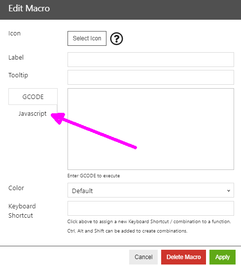

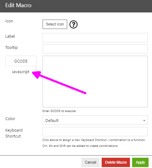

    Ok, How long can lead screws be used for this?
    I still can't get the macro to pull up correctly. I went and uninstalled and reinstalled CONTROL and have pasted the code multiple times, but I get nothing when I click on the icon that is created when the macro is created. The macro still will open correctly and I see the UI if I have it open upon startup of CONTROL, but then I have no way of connecting to the uno without exiting the macro. If I exit the macro and connect, I can't get the macro to open back up by clicking the icon. Any idea what I can try?
    THANKS!!
  2. David the swarfer
    3,604
    1,979
    you did select the javascript tab, right?
    upload_2022-2-9_11-30-52.png [/QUOTE]

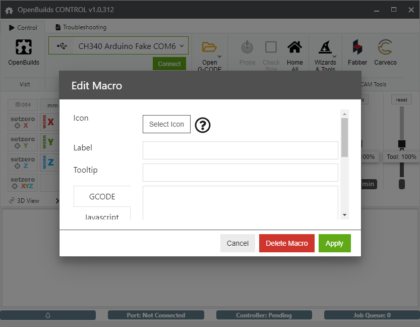

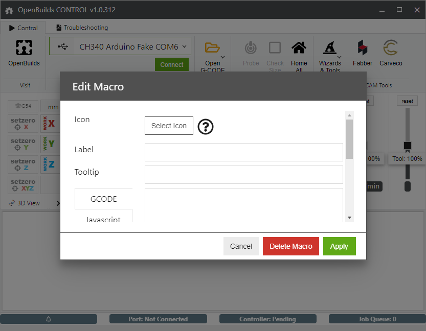

    Yes, and it will open up the macro on startup as seen in screen shot below, but it will not open when the macro "icon" is clicked on the main open builds CONTROL interface. It just does nothing.

  5. Peter Van Der Walt
    Builder Resident Builder
    15,699
    4,511
    Up to 1500mm: with the tensioning system C-Beam® Tension XL Linear Actuator Bundle
    Macro is not designed as an auto-run macro.
    Ctrl+shift+i > console log tab > F5 to refresh. Any red errors in log?
    If not, proceed to connect and then click macro button: any errors?

  7. Peter Van Der Walt
    15,699
    4,511
    From your screenshot:
    Shows its a GCODE macro not Javascript... Pasted on the wrong tab. Delete and recreate the button as a JS macro.
    Then it will show as:

    152
    18
    I pasted it in the javaScript tab, but there was no apply button. So, I had to click back on the gCode tab in order to apply and save. It was still pasted in the javaScript tab, but it was showing as a gCode on the main screen that you pointed out. It wouldn't work, but I just tried on a different cpu and the apply button appears in the javaScript tab and appears to work. I will go back and see if it is there on my laptop.... I apologize it is never easy with me.

  9. Peter Van Der Walt
    15,699
    4,511
    Possibly the screen resolution on that machine is a bit too low if you didn't see the apply button

    Yes, there is only an apply button if I go back to the gCode tab. I don't understand why it would display there but not the javascript tab, I have the resolution set as high is it will let me set it on this cpu. Is there something else I can do?
    Thanks!
  11. David the swarfer
    3,604
    1,979
    ctrl+- to reduce the scale of the display, just like in any browser

  14. Peter Van Der Walt
    15,699
    4,511
    CONTROL v1.0.313 (not released yet, still in dev) or later now includes Scrollbars for the Macro Editing window to cater for smaller screens
