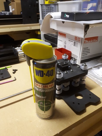

    I use WD40 Dry Lube (PTFE) on my screws, backlash nuts and any other moving part. - Was recommended on a thread on here

    Dry Silicone PTFE enhanced spray..stops debris sticking to the parts

    WD-40 is not a lubricant! Initially it displaces water (hence WD- Water Displacement) and then once it dries on the surface, it actually attracts moisture.
    Go with a dry- PTFE or graphite- lube, or a light 3-in-1/sewing machine type oil.
